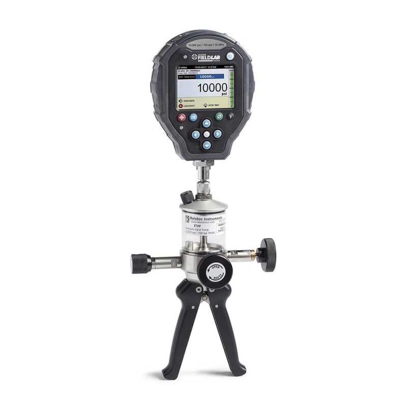

I need to regularly calibrate 10,000 psi pressure gauges (hydraulic stressing applications).
I want to do this now in-house and want to know if anyone has experience with RALSTON or FLUKE pressure gauge calibrators with their respective manual hydraulic pumps.
Specifically, I am looking at RALSTON FieldLab calibrator.
I would send the calibrator back for yearly NIST-traceable calibration.

Just to clarify, the unit I am proposing is not a deadweight tester. The system I am thinking of getting uses a hand hydraulic pump:
The reported accuracy is 0.02% of FS for 0 to 2,000 psi range, and 0.1% of reading for 2,000-10,000 psi range.
Any input on such a setup?
What kind of tolerance/accuracy are you looking for? The small hand pump calibrators are great, but getting them up to 10,000 PSI several times can be quite a bit of exercise.
CAT dealer I worked at needed to add a calibration procedures in shop for higher pressure sensors and gauges, we used a Fluke 743 that we already had, and added a Fluke 750P31 10,000psig pressure module, for a pump we used either OTC or Enerpac hand pumps we already had on hand for porta power rams and other tools. We added a needle valve on the output of the pump that gave us some fine adjustment, and found the larger pumps with longer handles used less effort and made finer adjustment of pressure easier.
Not sure if this would meet your needs, but may. You may also consider renting a couple different calibrators and seeing which one meets you needs best before spending the money to get a new one. Transcat has quite bit of tooling available for rent and in some cases also has free or low cost demo equipment.

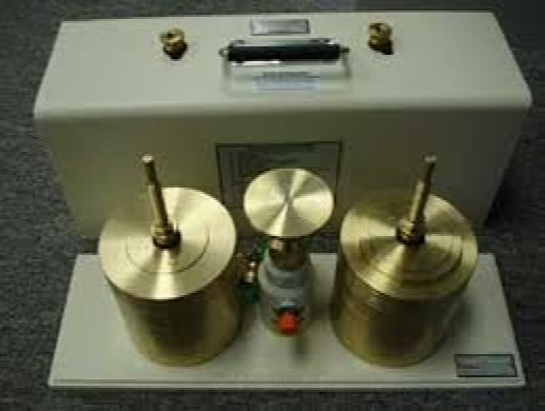

That looks almost as bulky as a deadweight tester.
The deadweight tester we had came in a stout metal housing where the tester was built into the base. You carried it like a small suitcase setting it where you wanted to use it and flipped a few latches and the top came off with the carrying handle. Everything was there and ready to go.
Deadweight testers are beautiful fundamental physics. Someone will be calibrating those gauge type ones with a deadweight one. They don't go out of calibration. You don't need to have them calibrated unless the laws of physics change. They're easy to use. They're obvious.
You should re-consider.

True dat! But, there is actually gravity variation all over the surface of the planet and these testers come with a table you can use to correct for it if you need even higher accuracy.

A deadweight tester would be indeed 'perfect' but they are pricey, for up to 10,000 psi pressures they run over US$10k. So about 3 times the price of a pressure gauge calibrator like the Ralston setup.

Given that this is a construction application/setup, maybe a dead-weight tester is overkill? Thoughts?
With electronic strain gage items like the pressure calibrator and load cell, you will want to get them recalibrated yearly at least. Strain gages have drift issues over time. As Keith said, deadweight testers really don't go out of calibration (ok, the cylinder walls might wear over many, many thousands of calibrations and very slightly affect the pressure, but that is just a change to the area term in the calibration equations, and away you go again).

If it were me, I'd go electronic. It's a secondary standard but your customers are not demanding a primary standard (deadweight).
Didn't realize that deadweights cost so much. We bought ours on ebay which has a lot of them.

For your work the pressure gauge unit will be fine.
The only issue is the temperature issues, in very hot or cold applications the TempCo corrections can get a little iffy.
