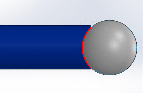

I am trying to simulate a simple model in Abaqus- an elastic spherical shell being sucked into a rigid tube. The diameter to the sphere is greater than that of the tube and I want to study the large deformation of the shell into the tube.
I am unable to define a load to simulate the suction pressure on the shell applied by the tube. I am using Pressure as the distributed load, which can only be defined for a particular surface. In this problem, the surface on which the suction pressure will be applied will constantly change as the shell enters into the tube. I would be grateful if anyone can help me defining such suction pressure.

Actually I was thinking about something like this (suction pressure applied to the red part of the sphere):
It should eliminate the need for variable loaded surface.
Thanks for your answer,
Yes, it is great if you could tell me how to apply the load without using the fluid in Abaqus Explicit, as shown in the above figure.
Fluid is not necessary here, pressure applied directly to the sphere in the outward direction can pull it towards the tube (it should work well in vacuum too, just leave the motion of the sphere in this direction free). Since it is applied only on the small region of the sphere, there will be no problem with variable area of load application during the aspiration process. You can try with prescribed displacement too.
