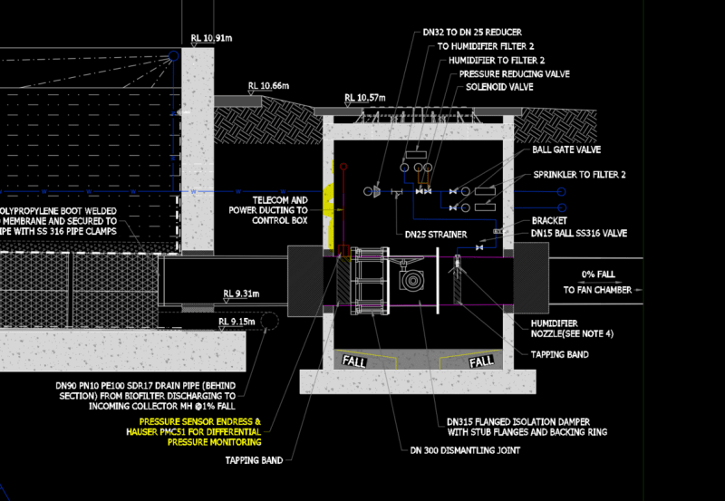

I have taken over a project where the original engineer has moved on. The project is a wastewater pump station with a fan blowing foul air from the wetwell through a biofilter
The design report and other design documentation states the following:

I understand that this pressure drop (10mbar)was intended to be measured between the suction side of the vent and downstream of the fan and any fluctuations would result in an alarm being set off to adjust the fan, locate bypass through the media or replace the biofilter media. The drawings were prepared incorrectly with the pressure sensor tappings both being downstream of the fan, effectively measuring the same pressure.
From the text above i understand that the measurement should be measured between the fan (vent downstream of the fan) and the other side of the biofilter (atmospheric pressure) as this is the resistance to blow through the media
My question is would we be able to measure just the gauge pressure in the vent downstream of the fan. Gauge pressure being measured relative to atmospheric would show that the pressure in the vent is targeted at 10mbar (100mm H2O)?

By schematic I more meant a schematic how everything is arranged schematically. it is a bit hard to tell from the actual construction document.
Usually for a filter we use a single gauge measuring up and downstream of the filter. You just run tubes to the appropriate locations. in theory using 2 separate gauges can work. but each gauge has in inaccuracy and those can add up if the one happens to to show + 1 ", the other is -1" for example. If you use only one gauge, you don't add errors, and if airflow is zero, you see it being zero (and if not, you know it is wrong). You kind of need to have both gauges at the same location anyway... so I don't see how that would make things simpler.
I am a civil engineer so forgive my schematic.
But from what you are saying you would measure either side of the filter. In our case the "other side" of the filter is atmospheric so if we only measure gauge pressure in the duct between the fan and filter it is effectively measuring the difference between vent pressure and after filter (atmospheric pressure)
The sensor we are proposing has relatively large steps in measurement (20mm water) so once the fan is set it will only set of an alarm or change fan speed when the pressure drops below 80mm or over 120mm

>My question is would we be able to measure just the gauge pressure in the vent downstream of the fan?
Yes, but frequently gauge pressure (GP) transmitters (one pressure port; internally vented to the atmosphere) are not available with a sensing range as low as differential pressure (DP) transmitters (high side port and low side port).
So pressure measurement in a very low 'draft' range are frequently done by DP transmitters because the DP's sensing range matches the application requirement. The low side port is left open to the atmosphere (or plugged with a scintered filter to avoid having insects make a home in the low side sensing cavity.)
