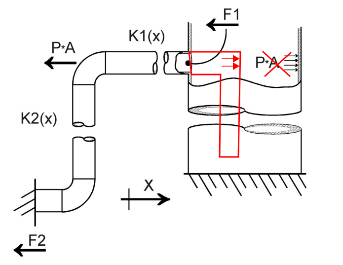

I believe pressure thrust can be considered as just an outward axial load at the nozzle in any program if it is not included as specifically "pressure thrust" input. It acts in the same direction as axial loads at nozzle so can be included in same axial forces, as it has the same resulting effect I belleve. Pressure thrust exists since piping connecting to equipment has a force on the first elbow or directional change which is transferred through the piping axially to the nozzle. An opposing pressure thrust exists in the vessel internally that balances the external piping pressure thrust but it must be transfered through the nozzle and vessel shell at the connection, although there is no net force on the equipment. WRC 107, 297 and 368 give methods for analysis of pressure thrust.
Just pay attention how to use pressure thrust. If you use the full PxA as additional axial force, you will be wrong and you will induce unnecessary reinforcement at he nozzle junction. Read the article from COADE provided by Snickster to fully understand the basic theory.
In short, PxA will be an External force in the piping system acting at the first elbow, not at the nozzle junction nor at the face of flange. By equilibrium analysis, this actual "extra" force at the nozzle junction or at face of flange due to PxA will be reduced dramatically. So if you apply PxA at the nozzle junction or at the face of flange, that is unduly.
It is pipe stress engineer to include pressure thrust in CAESAR II analysis, and then produce loading which already includes the effect from pressure thrust at the nozzle junction or face of flange.
It is vessel engineer to qualify the nozzle junction while pipe stress engineer to qualify the flange rating per UG-44(b) or other approach. I am totally against vessel engineer to perform UG-44(b) if you understand the basic. UG-44(b) shall be written in B31.3.

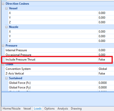

Not sure the correct answer but I'm sure the question arose because in Caesar II WRC 297 evaluation, it contains a check box for "include pressure thrust" or not. My understanding is similar to Snicksters post - this is only required if the nozzle extends inside the vessel and otherwise provides a place for that force to go that is not the opposite vessel wall. If this is wrong I'd like to know too.
