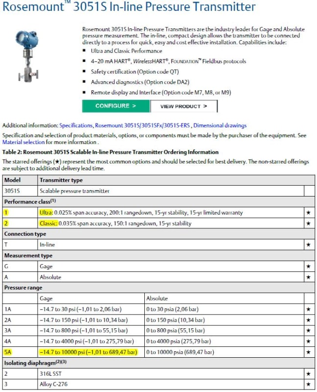

In the smart transmitter world, the reference accuracy applies to the configured span as long as the configured span is within a stated turn-down range. For the 3051S, that turn-down ratio is 10:1. Your 200 bar span is only 3.3:1 turn-down from the 690 bar max, so the 200 bar operating span is well within the turn-down range for the stated reference accuracy value to directly apply.
But you need to be very specific about which model you're talking about. I'm using the product data sheet found here:
Link

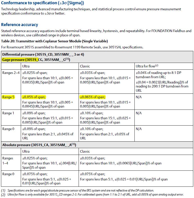

And you need to pay attention to the note (1) next to the performance class listing for the choice of ultra or classic. That note is on page 22 (pdf) and refers you to the reference accuracy table, where one finds that the range 5 is a 0.05% reference accuracy, not the 0.025% reference accuracy. (It is a game of specsmanship, as you know.)
The 200 bar span for your range 5 would be 0.05% of 200 bar, or 0.1 bar
That assumes that your model is "ultra" model and not the "Classic" model.
