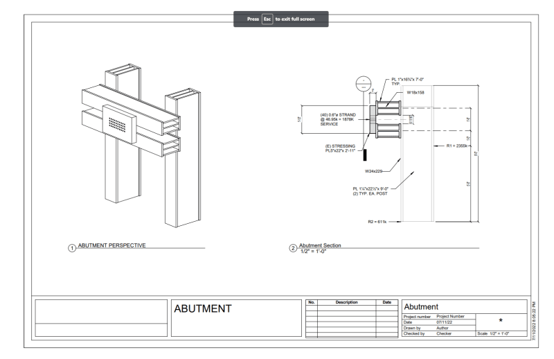

I am reviewing this abutment design that was sent to me for a prestressed girder bed and thought I might get some feed back from the collective.
The STRESSING PL5"x22"x 2'-11" is existing and it is hoped that it can be reused. Given the required loads, it can span about 10". To me, this use would appear to load only the W18 web and one of the 1" lateral plates but not both. I also will produce significant torsion in the built-up W18 which would require web stiffeners at the bearings to prevent lateral distortion at the ends and should probably also have them at the center.
What say you?
Some big kips there!
Is the 5" bearing plate attached to the flanges of the W18's? The upper W18 eccentricity is equal but of opposite sign to the lower W18 eccentricity. Can you provide end-restraint and 'lace' the two 'exterior' W18 flanges together as the 'interior' flanges pass over the vertical W24's?
Also, I do not think your R1 and R2 reactions are not in static equilibrium.

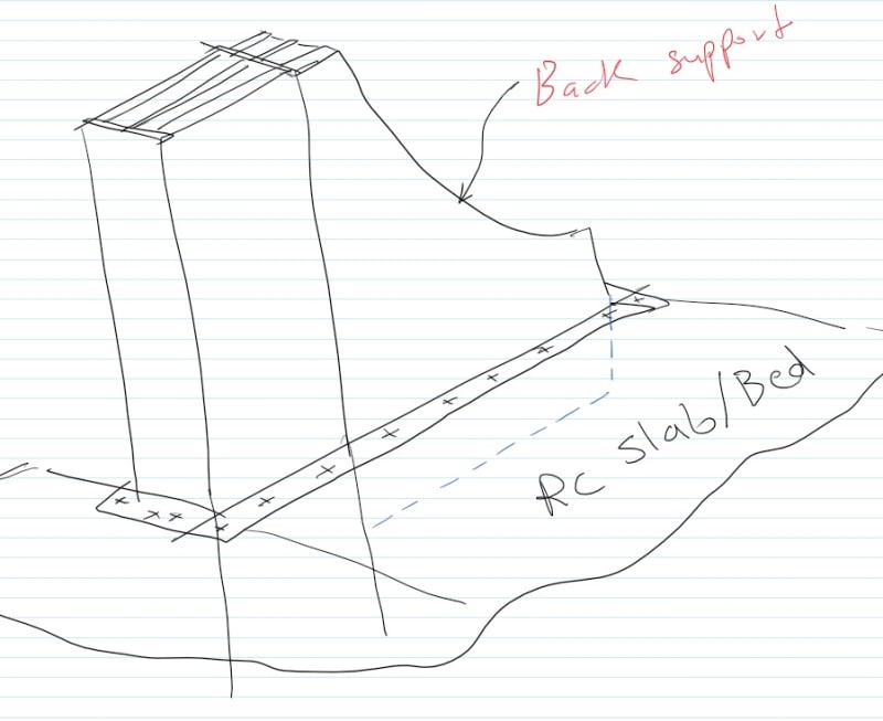

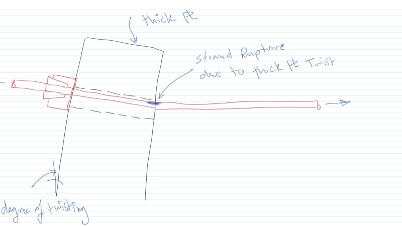

did worked for similar application
[large steel sections W18X158 behave quite elastic like spring and easily deflect]
so do as much you could stiffeners and back-support
Since every small inclination will twist your anchoring PLATE [Cause stress concentration around strands perimeter ]

Yep, big kips!
The 5" bearing plate is a loose item which is clamped to the horizontal strongback with threaded rods and can be moved sideways up to 9".
The reactions are from the worst case for the posts which is where the bearing plate is offset 9".
All of these items are loose. The horizontal strongbacks are also clamped to the posts so that they vertical location of the strand group can be adjusted.
adn26 said:
@ Prestressed Guy
cl/cl of the posts is 6' and the W18x158 with (2) 1" thick x continuous side plates has an Iy = 4384in4 That will come to a deflection of about 1/16". The W24x229 with (2) 1¼" thick x continuous side plates has an Iy = 11,445in4
The total accumulated design displacement of the system at the strand is just a bit more than 1/4"

The bed is an existing gravity bed and has a mass footing with a 3'-6" x 7'-0" x 5'-0" deep bearing socket for the posts. It will have a fitted compression strut to hold the bottom of the post against the front wall.
Due to available steel sections, these abutment posts have been changed to W27x368 which have the required moment capacity but are short of the required 1880k of shear. We will be adding a 1" web doubler from the lower cross beam to the top support which gets øV up to 1945k. We plan to put a pair of web stiffeners on each side at 9" o.c. centered on each load and reaction to prevent web sidesways buckling or web bending (in-plane rotation of the free flange) but I am not sure how to size the thickness of a web stiffener that is welded to a 2.46" flange.
Any suggestions as to how thick to make them?
