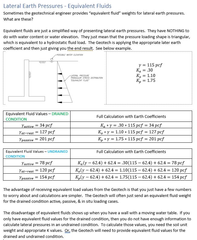

'equivalent fluid pressure' is a simplification allowed in some building codes...so a certain soil type can be simplified as 30psf/ft, another as 45psf/ft, etc. Some geotechs will even put that in their report to make things 'easier' for us small minded structural engineers.

Instead of calculating Ka using the friction angle, the IBC gives out the pressures in pcf - they're basically just doing the work of finding Ka * your soil unit weight for you for simple cases. The term used in literature is typically "Equivalent Fluid Pressure method" (EFP)
-Laurent
Pham is correct....equivalent fluid pressure is just a simplification.... see below
