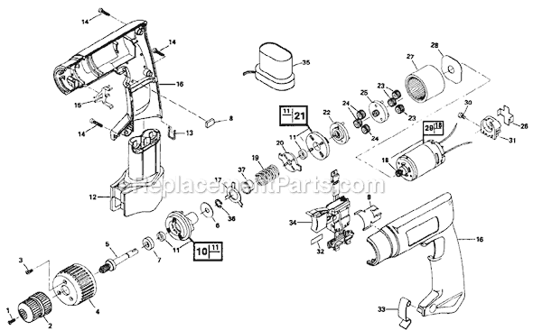

Reverse engineer a common drill clutch
Correct me if I'm wrong, but a power drill clutch limits torque whereas I am trying to limit number of rotations.

Once the max torque is reached it disengaged.
