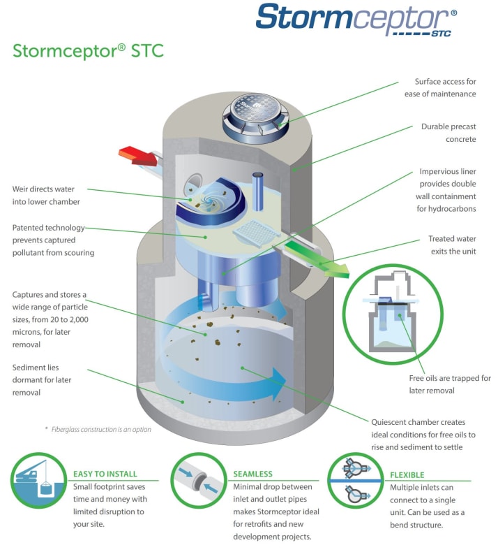

something like this?
If I understand your concept, the initially captured water is released to the downstream drainage system once the volume is exceeded. So this is a form of detention, but I don't believe meets the intent of "capturing", which is to not allow the runoff to proceed downstream.
isn't your option the same concept as using an orifice controlled detention tank - you are not retaining the first 5mm on site, you are just detaining it until it fills and empties. If your proposal is allowed i would think a detention tank with orifice would be better as the flow is lower to avoid increasing peak runoff from the site
What is the reason for holding the first 5mm? is it to catch the first flush (ie treatment) or discharge capacity issues. if it is treatment the stormceptor cvg posted would manage this, Spel also make something similar. Some systems are designed to catch the first flush and then as flows increase they are diverted around the treatment device
