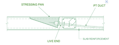

Hi All,
Structural engineer from Australia here.
I'm currently working on the construction phase of a project where the floor system is PT suspended slab, and our office is detailing the PT slab.
The typical tendon length on this project is >24m.
The design was completed using popular software in Australia which are RAPT and RAM Concept, with its default tendons anchorage loss values and default initial jacking stress (85% minimum breaking load).
Due to site constraint, most of the PT anchorage are done by pan stressing (refer snapshot below).
However, when the elongation stressing record were sent by the contractor, we noticed that the actual elongation on these pans are much lower (up to approx. 15-20%) than the theoretical elongation from RAPT or RAM Concept.
We requested the PT subcontractor to restress those tendons, however, what they did was to apply a jacking force >85% of the minimum breaking load of the tendons to achieve longer elongation.
I'm not too sure if this is the correct approach as most of the pans tendons have low elongation and the risk of tendons snapping.
Could you advise on the typical approach in this situation?
Any help would be greatly appreciated.

Yes, they are constantly out for pan stressing. We have asked the contractor to ensure that the hydraulic jack is calibrated correctly.
For instance, we have 27m long tendons adjacent to each other with pan stressing on one and edge stressing for the adjacent, the elongation result we get is:
From RAM Concept: 186mm
Pan Stressing: 158mm
Edge stressing: 185mm
We'd accept if the elongation is about 10% lower than RAM Concept's results. 15% seems very low to be accepted.

For pan stressing a series of curved stressing barrels is used and the friction of these acute angles changes need to be accounted for in the friction calcs to better estimate elongations.
We have tried to increase the anchor friction coefficient to 5% to simulate the extra loss from the pan, but we still didn't get as short as what we found on site.
