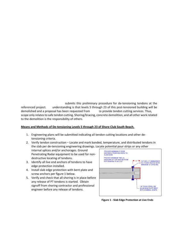

Does anyone else specify bent plates at live tendon anchors to control blow out during de-tensioning? I proposed it to a demo contractor and they liked the concept. 16" long x 1/8" thick 6063-T6 channel shape bolted top and bottom with total of four HUS-EZ screws. We were going to use ballistic blankets but we couldn't find a version with a way to reasonably anchor to the slab. How do you guys protect your live ends?

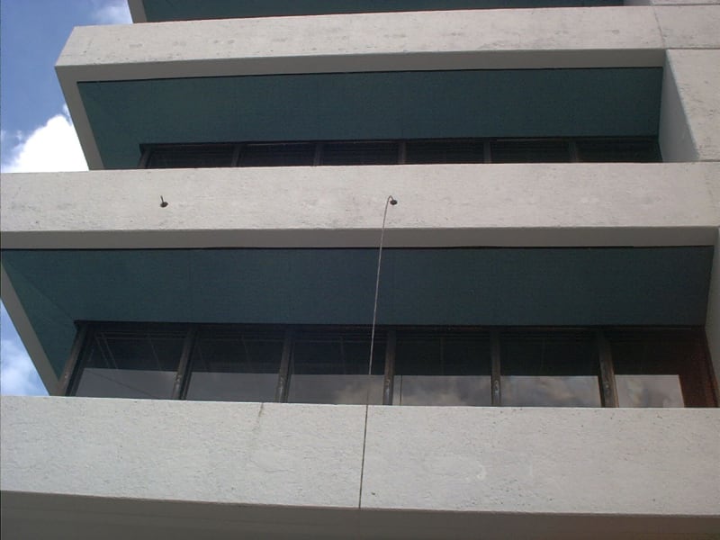

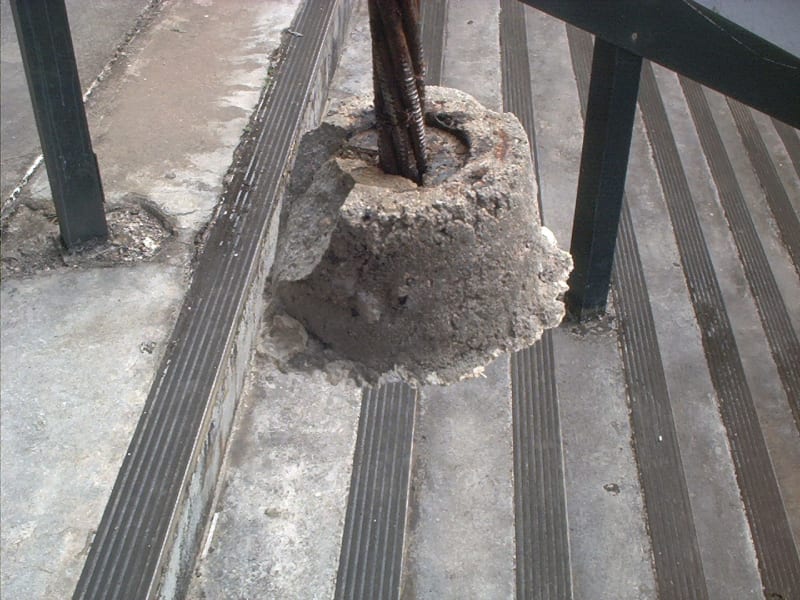

Nature (corrosion) did this:
The grout plug was still attached to the strand.
Found the wedges on the street about 50 feet away.

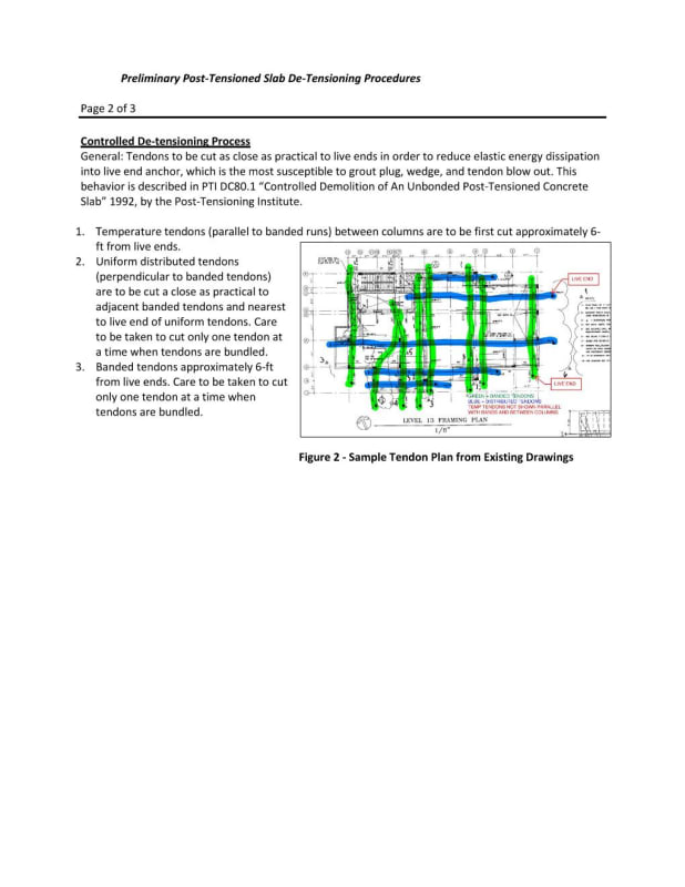

Ingenuity... what procedure do you normally use for detensioning?
I agree we are protecting the 1% chance. But, it is about risk not just probability. Our contractor scope is limited to edge protection and cutting tendons. Another sub is handling shoring and demo. Not a fan of this but we are not running the show. We are at a preliminary stage till our client has their proposal approved. Here is a concept de-tensioning they submitted with their proposal.

Mac - I'd recommend editing your image to preclude the building name and location.
