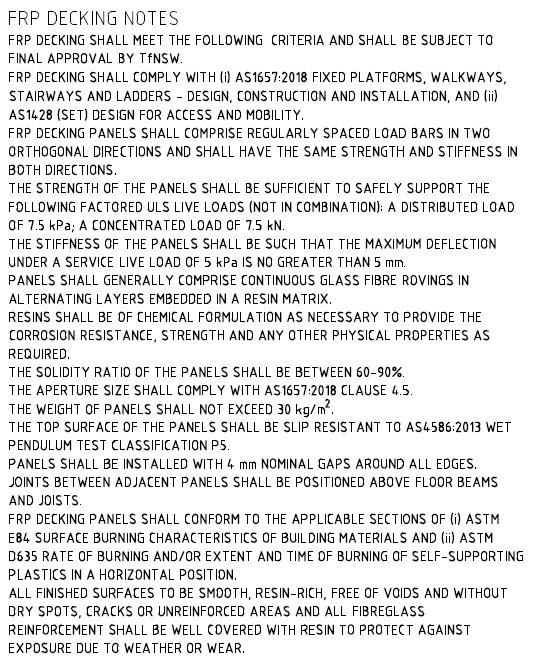

We do this in our specifications. Call out:
[ul]
[li]Depth[/li]
[li]Bearing Bar Spacing[/li]
[li]Bearing bar thickness[/li]
[li]Minimum Weight[/li]
[/ul]
The weight is very important. These suppliers have a million models, spacings and bearing bar shapes. They love to say, "this will hold the posted load" or "a tee shaped bar will do the same as an I bar" The only way to negotiate in their wheelhouse is the weight. I like 1 1/2-inch or 2-inch bearing bars, 5/8 inch thick at 1.2 inch spacing. They're very heavy. The manufacturers would rather have a big markup on the lighter grating.
We specified these notes on a recent pedestrian bridge. For this client, we were advised to be as general as possible with the specifications. But realistically, there were only about 2 suppliers on the market who could satisfy these.
and I add a note that the EOR is responsible for securing the FRP grating to provide lateral restraint as required for stability of the stair stringers and deck beams.
