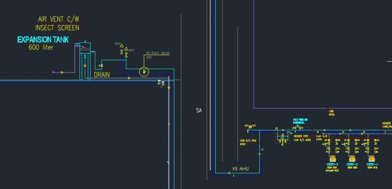

here is the drawings
I combine it to make it for the space. on the right is the pump room located on the first floor. the pipes goes up, up to roof top where the expansion tank is located at the height of 110. 2 pumps are running while 1 is backup. I also removed all the details on each floor where the FCU's are located.
I think it's still a bit odd to have an atmospheric tank on this system compared to a pressurised system, but if it works then fair enough, there is no significant additional head other than height of the building.

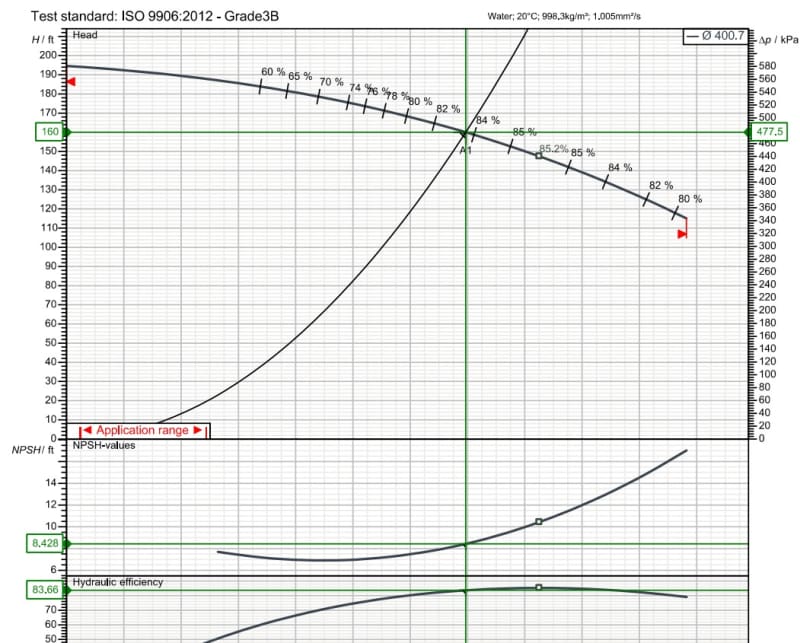

If the green line is your duty point, then at operating condition you're diff head is actually 160ft or as it shows on the other graph, 4.8 bar in water, not 40m.
So your running pressure is prob about 13.5 bar if the tank is in the hydraulic middle point.
But shut in head is 5.8 bar pressure plus the 11 bar in the inlet so 16.8 bar.
Definitely needs the 25 bar flanges for the first 2 or three floors.
But you seem to be right on the limit for a lot of things and I think you risk leaks and burst in the pipework and equipment on the lower floors if you go with this design. you wont' be able to set relief valves that close so you could be looking at having to set them at about 20 bar to avoid them popping off.
