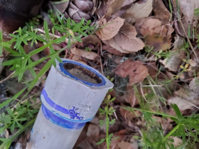

Here's the day's scoop. Took an ancient 2,000lb ratcheting 2 speed, with a brake, hand cranked, winch up to the site. Used that on a 1/2" safety line that was properly whipped and connected to the pump. We ran that line thru a Lewmar pulley at the top of our 15" double stacked scaffold thru a Prussic knot anchored to the scaffold, with one wrap around the winch drum. Someone tailed the lead off the winch drum.
We promptly extracted 60 inches of the pipe string. This was the very first pipe joint down from the wellhead. It was precisely what I guessed the problem was going to be after hearing they'd had two other riser failures in the past. There had been other show-stopping leaks in the pipe between the pump and the wellhead. Looking in the nearby weeds I'd seen the castaways of a prior failure. They were Sch40 PVC with the standard crap® adapters of the slip-to-male thread type. I expected to see one of them broken right at the incredibly weak problematic thread/slip interface.
Sure enough!
The entire string was 10ft lengths so there were a ton of those gawd awful adapters. Two every 10 feet.
The top joint failed and the pump and the rest of the string plunged to the bottom of the well. Luckily there was that safety line. Luckily the wire and the safety line and the bubbler line and the high and low float lines were all 200 feet long - the well depth. The pump was set at 170ft. We pulled it all using only the safety line.
Every 20 feet we drilled a 3/16" hole at the well-head that drained the twenty feet above us. Then unscrewed the bottom coupling and extracted the 20ft string and unscrewed the joint in the middle. One of them snapped clean off even though we only used our hands to unscrew them. It would've been the next one to crap-out.
I may replace the pump, a Gould 10GS15. However it was new in 2016 - 5 years.
My concern is it was installed with the ground lead unconnected. So I'd guess water has completely run down that wire into the motor area.(?) The other wires we simply soldered and wrapped with some electrical tape.. :/
It also fell to bottom while in operation and sat there running for 16 hours making an in-well geyser.
I also have to figure out what to use for the riser string since there's no way in hell I'd use adapter based sch40 again!
