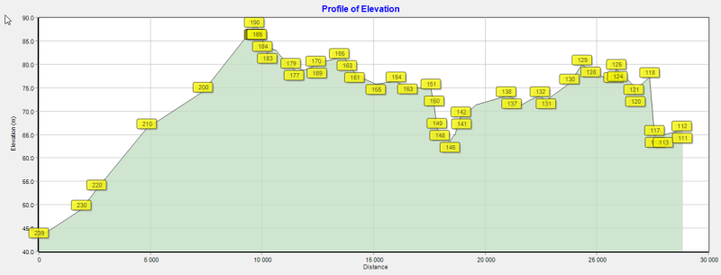

I'm working on an industrial water system where I am to use existing pumping station and pump the water to a new plant some 60 kms away. There are local high points on the way, but the hills are of lower elevation than the receiving point. So my pump has to provide sufficient pressure to pump over those hills. The classic siphon will not occur.
Do I still need to worry about possible vaporization? I read somewhere that the velocity difference on the upward and downward slope could cause flashing, and disturb the flow. Is this right? If so - how to calculate it?
If it's as obvious as I think it is (that no - it will not be a problem) then sorry for spamming. Internet is a great resource but sometimes the data is so fragmented it gets you scared without real reason.
I've attached an epanet's profile of pressure to visualize what I'm talking about. Generally you can see the pressure falling, since the terrain elevation and head losses decrease it. The local minimums display points of high elevation I'm worried about.
So long as your pipeline is
A) full of water and
B) Kept at a pressure of > 0 barg at all points
then you don't need to be concerned about the intermediate hills.
Your pressure plot indicates positive pressure at all locations so you are all OK.
The issue you talk about is "slack line" pumping where the flow can only just get to the top of the hill then falls away creating vapour and flow disturbance on the downstream section. This doesn't happen here.

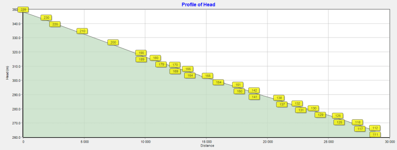

Can you also plot the profile and the hydraulic gradient?
thank you for your answer. The "just able to get to the top" thing got me worried - I saw around 5 forum topics about difference in velocity when pumping over a hill, and only one answer clearly stating that hydraulic gradient high enough means there's no risk of vapor creation.
From what I understand the "just able to get to the top" part means that the risk is in the start up, shutting off and, later, in system aging?
Here's the profile of hydraulic head and elevation. It's only partial, as the pipeline is quite long, and I woud either have to plot every 10th junction or so or make the graph hard to read.

You only seem to be giving us half of the profile, but I think you've got the correct design IMHO
What you really need to do is superimpose the Profile of head graph with the ground elevation profile.
Depending on how much pressure / head you need at the end of your pipeline you can then see what head you need to maintain a positive head pressure at all points.
If you have a large dip right at the end then you may need to maintain a back pressure to keep the pressure positive.
