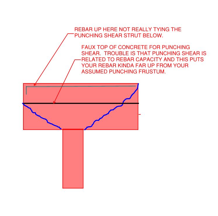

3) Rationally, one might consider the adjusted model below. It's not without some problems requiring the application of engineering judgment however.

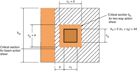

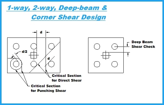

Dear Newbie, In general the depth of a pile cap is not less than 60 cm ( even for small size driven piles ) and selected around 2 to 2.5 times of diameter of piles. That is, punching shear usually will not govern..
However, the designer is expected to check the one way and two way 8 punching ) shear considering the probable failure scenarios.The punching perimeter is calculated with column or pedestal + d/2 all the way around and the critical section for one-way shear shear is calculated at a distance (d) from the column /pedestal face.
I just write ( footing shear punching ..) and search the web.. One of the outcomes;
Then write ( pile cap shear punching ..) and search the web.. One of the outcomes;
Does this respond answers to your thread ? If not ,tell your specific problem with some descriptive sketch etc and applicable code to get better responds.
What will be the solution for the model you have shown?

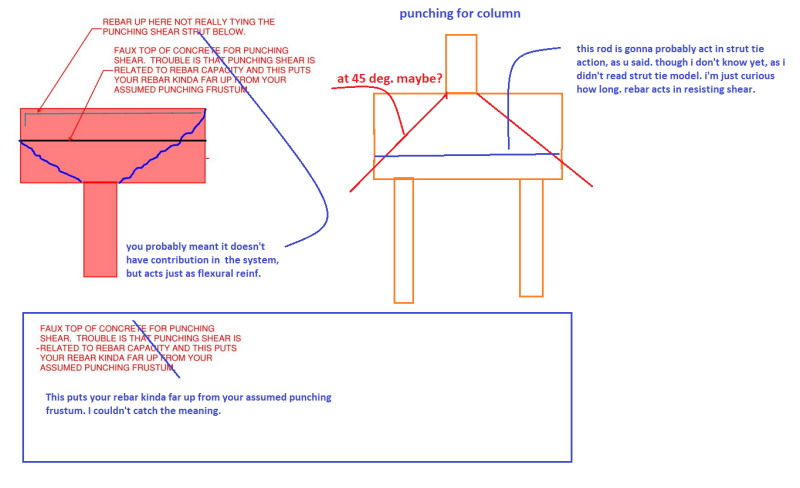

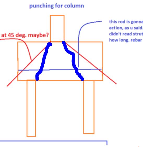

Doesn't that picture seems to work like punching shear calculations for an edge column??

Kootk and MSUK90, Thanks. You are right in approximating my question. I'm not much familiar with the Strut Tie model yet, If it works then what's the procedure of finding capacity.

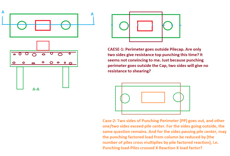

I'll explain a little what's troubling me.
*Typing error
Case 1: Are only two sides going to give resistance to punching this time?
Kootk, you have probably shown punching for pile.
For the case 2, which i have mentioned about cancelling out of forces, in the figure i shown the resultant shear will become zero, assume a pile cap where it won'r become zero.
Oh no, the resultant shear absolutely will not become zero. We were imagining a different situation previously.
When using a strut and tie model in a situation like this, it will not be the rebar that resists the shear but, rather, the diagonal struts. Naturally, it all has to come together as a complete system. It's helpful to think of strut and tie models as behaving like trusses in many respects. In many trusses, it is the webs that rest the shear of course.
If you wish to do sectional method checking of your pile cap, a good model is the one shown below. It will be different than standard code checks since the shear crack angles will be steeper than 45 degrees etc. The CRSI design guide on pile caps has a shear formulation designed to address exactly this.
