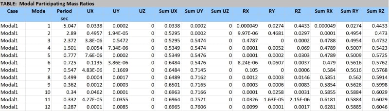

Hi there,
I am currently working on a 20+ story building (For educational purpose only) having dual resisting system (Moment resisting frames and concrete shear walls located in center). I intend to perform Non-Linear Static Pushover Analysis to capture non-linear response of the structure and to study Demand/Capacity ratios for in-elastic response of structure. However, when I performed Response Spectrum analysis, I got 1st mode of vibration as "Torsional mode", which doesn't make sense to me. Story-drifts are restricted as per code's limitations. Also Torsional irregularity checks are also okay (Considering eccentricity between center of mass and center of rigidity). Base shear for both, Equivalent Lateral Force Procedure and Response spectrum analysis also matches (approximately equal).
Since, Pushover analysis is applicable to structures whose response is dominated by its first mode of vibration (Which isn't the case here), although my first mode appears to be in rotation, my gut feeling says its translational. I am attaching Modal participating ratios, any sort of help is appreciated.
I think you need to double check your model, as the torsion is consistent throughout the modes.
Retired13, the first mode is clearly the dominant torsional mode at 44.3% mass participation for rotation, the next highest torsional mode is ~3% mass participation. Hardly consistent through all the modes.
Your structural system is very torsional, a 5 second torsional first mode period is miles ahead of your principle translational modes at 2.4-2.9 seconds.
This suggests you need more stiffness if you want to affect this fundamental behaviour. Stiffening the perimeter moment frames or thickening your core walls.
, that's what I meant, look at all modes. And as I suggested, "This suggests you need more stiffness if you want to affect this fundamental behaviour."

Thanks Agent666 and retired13 for valuable comments.
I did increase the stiffness of perimeter beams which lead to drop in fundamental time period from 5 sec to 4.1 sec. However, for second iteration, increasing shear wall stiffness didn't have any significant effect on torsional rigidity of structure. I have attached plan view of my structure; it's a 20 story building with 3 basements. It's evident that structure shape (rectangular) is playing its role in enhanced torsional effects(among common shapes, rectangle is the shape most suspectible to torsion). Kindly suggest me a solution to overcome this. For now, I believe that by introducing symmetrical shear walls might be a good solution.

You are quite right in your observation. I did notice that before and changed modal analysis from "EIGEN" to RITZ analysis, and this proved to be a game changer. Ritz analysis successfully captures higher modes. I was able to achieve 90% modal mass participation (translational) at 9th mode. Significant difference between Eigen and Ritz analysis!

Seems you already have a good handle on your situation. Below listed are for your information only.
- Remember that ETABS lists mode based on descending order of T and not mass participation
- Generally, the first mode of vibration is the one of primary interest.
• usually has the largest contribution to the structure's motion
• period of this mode is the longest
• shortest natural frequency and first eigenvector
- Significance of a mode is indicated by Mass Participation
Below is your original report with three modes that having high mass participation ratios redlined. The rank of importance thus is M3-M2-M1.
