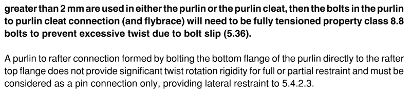

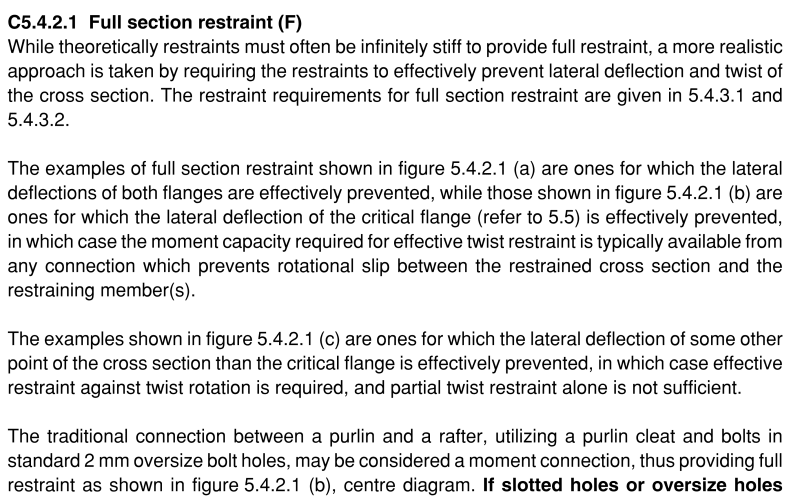

Here are the requirements you are missing in AS4100 regarding the purlin connections to achieve 'F' or 'P' restraint. Curious at braces/flybraces/other points of restraint if you don't put the slotted holes or accept you have to tension the bolts to /TB condition to prevent slip (and obviously check load is less than slip limit)? I would imagine it would be hard to achieve the required number of threads in the grip length from AS/NZS5131 I would have thought without packers or additional hardened washers as discussed in 5131.... All adds up to extra stuff to get forgotten on site. Different folks, different strokes, I guess.

Yep. As you point out we don't have that in our code, nor in practice. But nor would I even consider the connection between a purlin and a rafter to be a moment connection! So the point seems moot. Though it does make sense to avoid any oversize holes for fly braces.

I've heard Australian Engineers make Agent666's argument that our industry standard purlin connections are fundamentally non compliant with the code. E.g. AS4100 provisions for hole size which limit to +2mm oversize, and the bracing rules which prohibit anything which allows slip to be a bracing restraint.
