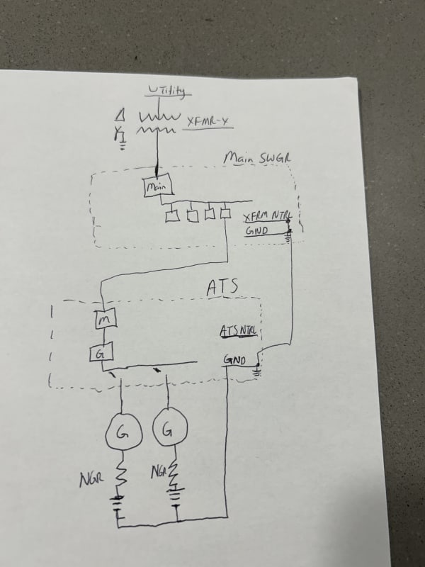

Good afternoon,
Im working on a distributed generation application where i will need to disconnect the neutral when switching from utility power to generator power. We have a bonded neutral to ground source (utilty transformer NTRL will be bonded to ground inside of the switchgear it feeds) and the back ATS controlling the gens will be grounded there as well while the gens are equipped with NGR’s that tie into that same common geound. Just looking for help understanding the purpose of having to disconnect the neutral in the event of a utility outage and switching to generator backup.

Thanks so much guys for the feedback. For clarity i put together a rough sketch of the system so everyone sees the application. Let me know if this clears things up.

I think that we need some additional information.
Is this a standby generator or or you exporting power to the grid?
If you are feeding the grid, there is a problem with the utility transformer.
When you back feed, the delta-wye transformer becomes a grounded wye-delta.
That is a problematic connection.
Utilization people make a clear distinction between the grounded circuit conductor and the neutral conductor.
Transmission and distribution people tend to use the terms interchangeably.
Admittedly most of the issues are on the wye side, but the utility may have a general ban on grounded wye-delta connections.
If that is the reason then they may accept the NGRs or they may demand that there be no connection from the generator neutrals and ground.
If you are feeding the grid you won't have an ATS.
If you are feeding the grid and supplying local loads then both the Main contacts and the Generator would need to be closed simultaneously. Automatic Transfer Switches are designed and constructed so that it is not possible for both Main and Generator contacts to be closed simultaneously.
If that is a standby generator then it is not going to work or be acceptable to the utility as shown.
Your ATS must have the Main or Grid contacts wired between the utility transformer and the main switch.
Your ATS must have the Generator or Standby contacts wired between the generator and the main switch.
Your ATS must have the connection to ground removed. That is the connection near what you have labelled ATS NTRL
There will not be a need to interrupt any neutral connections.
XFRM NTRL
GND.....Should be the only connection to ground.

On the sketch, what is the ATS transferring? Normally, an ATS would transfer the load between the utility feed and the generators in the event of loss of utility. I don't see that in the sketch. What is G and M in the ATS?
WAG....
Generator and Mains.
Which can never be closed simultaneously in a proper transfer switch.

Well, for starters it doesn’t seem your transfer switch is doing anything and won’t work anyway (mains and gen can’t close at the same time, assuming as waross guessed m is for mains and g is for gen).
You have a solidly grounded source and a resistive grounded source to serve the same load that is supposed to have a neutral with line to neutral loads, but the gens have no neutral.
It appears you can backfeed the grid with a delta bank (no ground reference, can energize with a groundfault) unless there’s interlocks in the switchgear not shown.
With no UV tripping the gens will try to pickup the grid when the power goes out and will hopefully trip on under frequency before they burn up or kill a lineman.
So yes, there a bit of improvement necessary. Switching the neutral is the least of your concerns.
As a start, the transfer switch should go between the transformer and the main (M should to the transformer, g to the gens, and the feed to the switchgear from between M and G in the ATS). Since you have L-N loads the gens should be solidly grounded and include a neutral. Ideally per waross the bonding should be in the switchgear for both sources and the neutral not switched.

and much appreciated as usual. I am leaving quite a bit out since i was just concentrating on what condition would trigger the need to disconnect/switch ntrl sources. From the feedback im seeing where everyone is getting hung up. The ATS will work, that part has been vetted. We are not doing a traditional tranformer/Main intercept but we do have CT/PT’s on the Mains (being fed by transformer) to sense loss of utility. That information will travel to the gen controllers to start the gen startup process. Upon that condition the mains will open, gens will start and synch (the “G” breaker will be open during that sequence) and when controller sees all gens on line the “G” breaker will close feeding the normally closed “M” breaker which will then back feed into the main swgr breaker as shown to feed the loads. Again the Main Swgr breaker will remain open during this condition which @waross is island mode. We will be exporting as well though.
