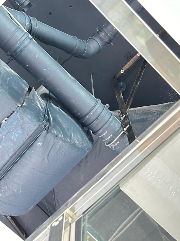

The storm rain water system in our 10-year-old, 5-story building is experiencing a persistent issue with water leakage. Specifically, during rainfall, the PVC push fitting on the mezzanine floor (which houses offices and a shared lobby) becomes loose. This fitting connects the header, which spans and links all drainage pipes from the various risers.
The movement and shaking of the pipe header during rain cause the Y or bend fitting to dislodge, resulting in water falling to the floor. Unfortunately, this problem has occurred consistently since the building opened, causing damage to equipment on the mezzanine floor, including a lift.
The branch pipe size in the risers is 110 mm, while the headers on the mezzanine floor measure 160 mm. The current support system consists of 10 mm threaded rods for both the header and branches.
To address this issue, there is a proposed plan to install new pipe supports using a C-channel bracket support measuring 100*50*40 mm. Before undertaking this potentially costly job, I would appreciate your insights and comments on the viability and effectiveness of this solution.

@ 1503-44 - These are PVC pipes with push fittings. There are no visible mechanical joints. I'll attach the images. As you mentioned, the slope needs to be rechecked. If the slope is incorrect, static pressure inside the header may build by while water filling the riser.

the lay out

Have to invent a glued collar, or something, or just replace the problem joints with thermowelds joints of some kind. Time to get creative?
Not easy to see what's going on there, but I think someone just cut a length of the pipe too short or installed it in the wrong sequence and then couldn't get it to fit. You need to build pushfit from the bottom up otherwise you have real fun getting it it fit together.
Maybe the picture isn't great, but the pipe looks like it isn't cut square?
Which bit is leaking exactly?
U-Bolt clamps do not restrain axially, in fact there is supposed to be a small gap between the U-bolt and pipe which is why they come with double nuts.
We can see the the pipe is shifting in the clamp by the white colored markings in the picture. Do consider replacing the clamp with one that offers axial restraint.

Agree about the U bolts for sure.
Push fit systems need to be restrained axially in line otherwise they move and detach.
If that lower line was held in place then you wouldn't have the issue. Looking at the marks it seems the main line is able to move a lot to the left hand side.
That's what you need to solve.
We can't see what's tot eh left. Can you sketch this up or add more photos?
