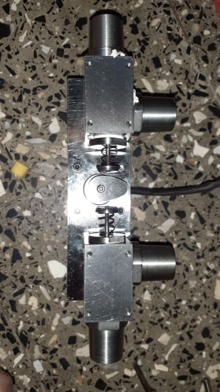

Secondly, I have seen people make Ventilators using stepper motors in this current Pandemic. Please see the attached image.
There is an inlet port with a flow-sensor that controls the outlet port with a spring controlled mechanism.
Any comments on this? The image only shows the in & out ports and the spring mechanism.
Now that you mention it, all PWM controlled solenoid valves I have seen are solenoid actuated spring return spool valves. The spring and the average force from the solenoid result in the valve position.

2. The Ventilator product using a Stepper motor. Will a similar tech work for my application?
1. The digital outputs on a PLC can be pulsed to mimic PWM. If the digital outputs has the correct voltages sufficient current rating for your solenoid you can pulse the solenoid directly. In this case make sure to use a flyback diode on the solenoid to protect the PLC. If the PLC voltage/current is not sufficient the you simply use a SSR as an amplifier.
2. Sure it could work but if you're going the distance of using a variable speed motor then you might as well attach that motor to any off the shelf positive displacement pump.
