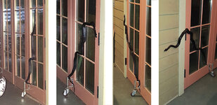

Just for S&G, attached are pics of the homemade Nanawall I mentioned, complete with uninvited guest.BlackSnakeSm.jpg
forgot to mention the most interesting detail about the 10' homemade Nanawall project which consists of two 60" sets of two bifolding 30" french doors, inner door hinged to jamb, outer door hinged to inner door. - Even with the gate casters I assumed I would be asking too much of the individual door's construction, so I routed right angle channels on all four "corners" and screwed 1/8" thick right angle steel braces in place, then puttied over. Worked like a charm
