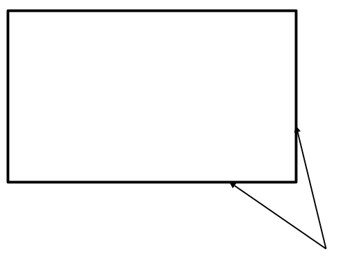

Hi LWolf,
Thanks for your reply. Let me repeat my question with an example
Lets say that I have sketched the above rectangle and have projected it on to a support. And I want to select/extract the two sides (pointed by arrows). How do I go about it? Because Project does not contain any sub-entities (at least not displayed in the tree).
There are several ways to avoid this B-rep problem and have reliable updates.
One is to create 4 GSD lines and project them separately. Keeping 4 distinct objects that will never get lost.
Or, in your sketch you could create 4 output features of the 4 sketch lines you created. These can be projected separately too.
Or there are clever ways using KWA knowledgeware commands to stabilise b-reps if you have the License, the knowledge, and the time.
^^Thanks for your reply. It was definitely helpful. Need to explore option #3... We have a couple of full Catia license and so that is certainly not an issue...knowledge & time...now those are different aspects. Are there any good & easy tutorials you'd recommend to get started on KWA Knowledgeware?
