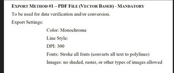

Hello can someone please help me determine if NX can make a PDF per these requirements?
PDF File-Vector Based-Mandatory
Export settings:
Color: Monochrome
DPI: 300
(I do not know if the standard PDF export is a vector based file)
I don't think that NX gives you direct control over the DPI, but I think it has your other options covered.
colors: black on white (monochrome)
output text: polylines (converts fonts to lines)
NX output is vector based for unshaded views generated from the model (I think shaded views do use rasterization, but I'm not 100% sure). Of course, if you have any raster images in the drawing, these will be output as raster images in the PDF.
