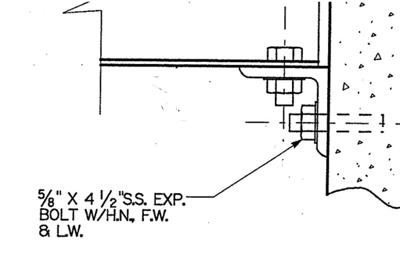

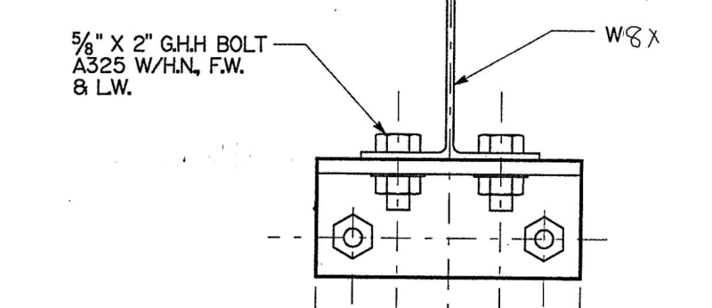

I have a structural detail drawing that is calling out information for bolts.
It says the following (see images below):
Is anyone familiar with these call outs for bolts?
I know what "A325" is, I believe "S.S." is for Stainless Steel, and "EXP." is for Expansion Bolt.
I am not sure what the rest mean.
Suggestions/comments are appreciated.
Is there an abbreviations table in the up front drawings? Your interpretations seem sound.
Below are some guesses about the rest:
H.N. = Hex Nut?
G.H.H. = Galvanized heavy hex?
L.W. = Lock washer?
F.W. = Flat washer? Or fender washer?

What the drawing shows is perhaps less important than what was actually installed. The contractor probably didn't understand those abbreviations either.

I think a site visit should be able to determine if the bolt in the wall are 5/8 stainless steel, and if the bolts through the flange are 5/8 galvanized. Those are the main things.
