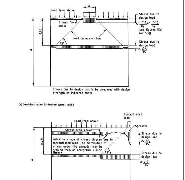

This snap from BS 5628-1

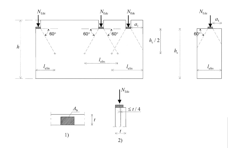

And this is from BS-EN -1996-1

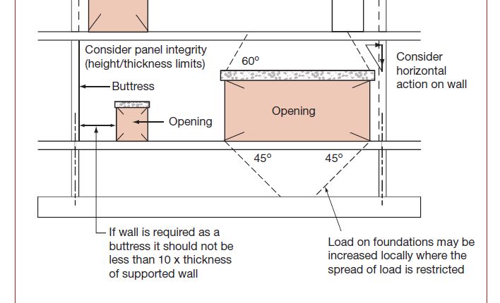

This snap is from Institution of Structural Engineers manual...showing the load path..
