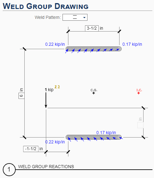

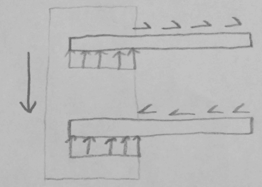

Does anyone know why the eccentricity is taken as joint plus plate width when checking the rebar capacity in PCI handbook wall-wall shear connection example?
Shouldn't e be joint only?
