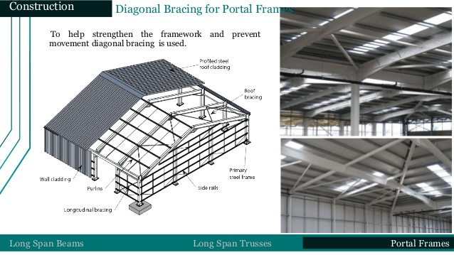

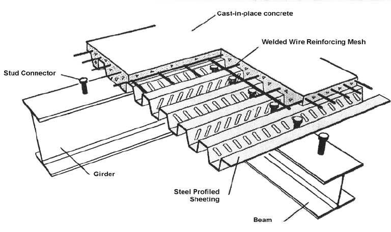

I am fully confused, as your sketch showing elevation view, with the word "cladding", so it is supposedly a view into the wall. But there are studs shown on a beam, and the repeat mentioning of slab, made it feels like framing for a composite slab. Please review the sketches below, and see what is the system you are talking about - metal wall, or composite floor slab. (Also note, the purlin is a roof member supporting the metal deck, is that mean you were thinking about roof diaphragm?)

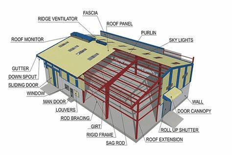

Here is another good illustration of metal building components.
