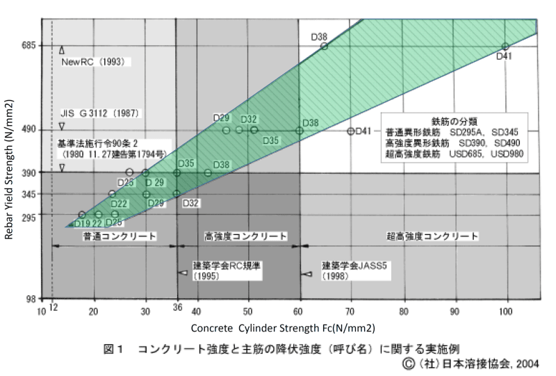

Before I got a chance to do anymore digging this morning, one of the seniors (Japanese structural engineer) in the department decided to weigh in.
He provided the following graph, showing optimal rebar grade versus concrete strength based also on rebar size.
It's apparently based on academic research, not bldg codes, but is widely applied in Japan.
Anyway, I think it is one way of handling and showing the problems that Agent666 and everyone described.
Thank you again for your help!!
