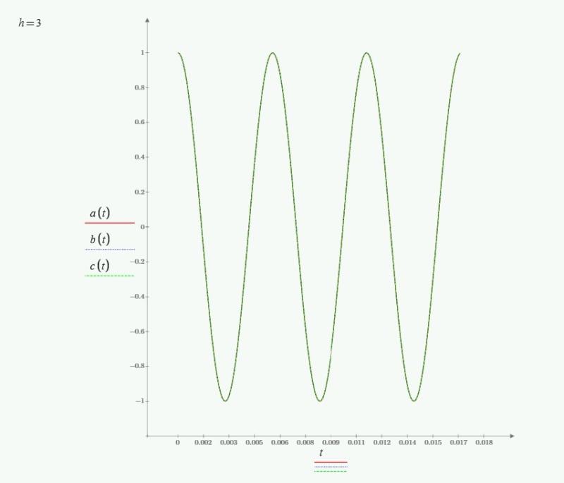

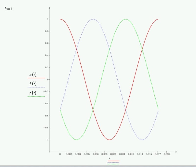

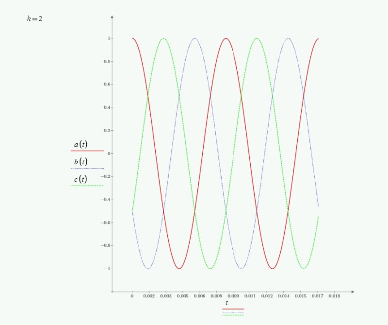

A bit of Mathcad fun I had in my files: Phases are all shifted 120 degrees based on a fundamental 60hz frequency. h is the harmonic. Note the fundamental is absent in the h=2 and 3 graphs.

If you double the fundamental frequency, you've simply doubled the speed of rotation. B still lags A by the same 120 degrees based on the new fundamental. This is not the same as harmonics. The h=2 graph above shows acb rotation instead of abc. Consider this a graph with the fundamental filtered out. Cosines are shifted by 120 based on fundamental.

I'll comment on Stevenal's figures in order to try to tie the two explanations together, because we're saying the same thing in a slightly different way.
The critical assumption for constructing his diagrams that I'd like to highlight again:
And equivalently all harmonics are shifted by the same time duration (call it t-delay) which corresponds to one third cycle of the fundamental = 120 deg of fundamental.

[li]t-delay/T1 = 1/3 cycle of 1st harmonic = 120 degrees of first harmomnic => this is positive sequence by our definition[/li]
[li]t-delay/T2 = t-delay/T1 *(T1/T2) = 2/3 cycle of 2nd harmonic (240 degrees of 2nd harmonic) => negative seq[/li]
[li]t-delay/T3 = t-delay/T1 *(T1/T3) = 3/3 cycle of 3rd harmonic (360 degrees of 3rd harmonic) => zero seq[/li]
[li]t-delay/T4 = t-delay/T1 *(T1/T4) = 4/3 cycle of 4th harmonic (480-360=120 degrees of 4th harmonic) => positive seq[/li]
[li]t-delay/T5 = t-delay/T1 *(T1/T5) = 5/3 cycle of 5th harmonic (600-360=240 degrees of 5th harmonic) => negative seq[/li]
[li]t-delay/T6 = t-delay/T1 *(T1/T6) = 6/3 cycle of 6th harmonic (720-360=360 degrees of 6th harmonic) => zero seq[/li]
[/ul]
