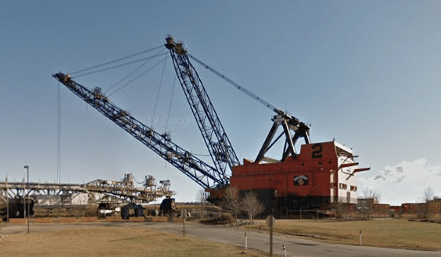

For fast response,the static exciter may output 200% until it sees that the generator output has reached the set point and then drop back to the set point.
This gives very fast response to control action on large machines such as draglines.

The max speed of the lower drive of the main hoist was limited to less than the maximum hoisting speed.
If a full bucket was lower to fast it would go into runaway.

The machine has been decommissioned and placed on display for over 10 years.
