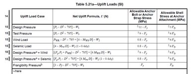

2. Code mentioned that for uplift check, weight of product over foundation could be considered "in the case of seismic load". Does it mean for load cases without seismic load, product weight shall not be considered to resist uplift?
True.. product weight shall not be considered to resist uplift for the wind and internal pressure . Pls look Table 5.21b—Uplift Loads.
From Table 5.21a, SI, I cannot see that product weight is not considered.
Look at the Net Uplift Formula, one cannot see the product weight since the product weight resists to uplift and you must consider that the tank could be empty. Copy and paste of the relevant snippet ;
How could we know that if product weight is considered in seismic case?
Table 5.21a gives formulas for uplift,Annex F.8 also gives 3 formulas.
What is the difference?
Mrw is the seismic moment and the seismic weight calculation includes content weight (see Annex E)
This is the clause (F.8.2) . The counterbalancing weight, in addition to the requirements in 5.12, shall be designed so that the resistance
to uplift at the bottom of the shell will be the greatest of the following.) . and this is additional requirement for foundation and not for anchors .In this case , the counterbalancing weight is the foundation weight.
