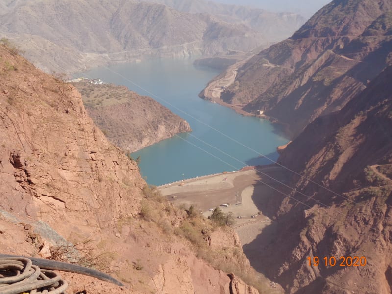

Please do not share photos . . .
I am taking the picture looking upstream. I am standing at about el 1300 m (the crest of the dam) at the core area. The "cofferdam" holding back the reservoir is at el 1075; water level is 1065. Base of the dam is about el 980

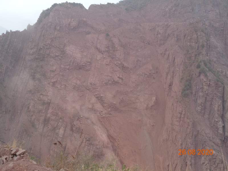

Looking from left to right bank - standing at el 1300 (again) - if you look closely you can see a few ants on the slope - these are large excavators - pushing down an access road.
Wow!
