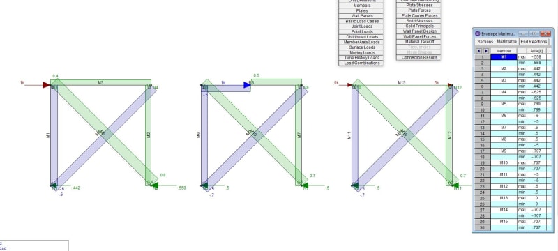

Here it is modeled in RISA with "rigid" members. Hopefully the image is legible.
well I could just read it with it zoomed 500% !
but scenario 2 (loading at the mid-point) and 3 (rigid 3-4) have the hand calc 50/50 distribution.
