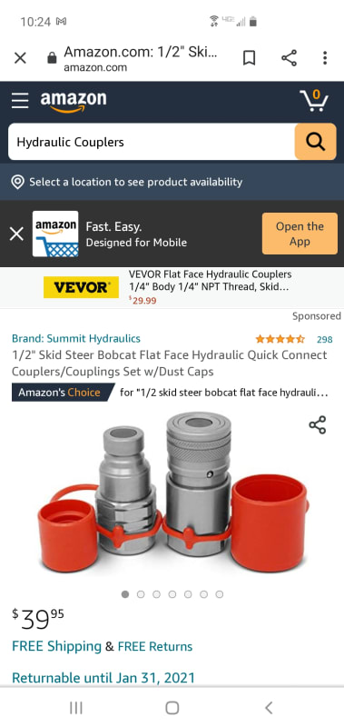

Hey everyone,
I've been searching online for a specific type of valve but have had no luck and figured I'd ask here. I'm looking for a male/female valve kind of like what is on the bottom of a Keurig water dispenser. The female valve would connect to the bottom of a container filled with liquid and in its normal state it is closed and sealed. When that valve connects to a male valve it allows liquid to flow between the two. I've searched for quick disconnect and relief valves but have only found pretty big ones that seem to be meant for tubing and have a manual button you have to press in the unlock the two connections.
Any help with the name of this type of valve would be appreciated.
Thanks!
What sort of size or pressure are you looking for?
I've used 1/4" gas tubing before now.
Normally quick connect needs some sort of mechanical clip to stop them coming apart.
What are you looking for in terms of connect/disconnect?
Like these?
