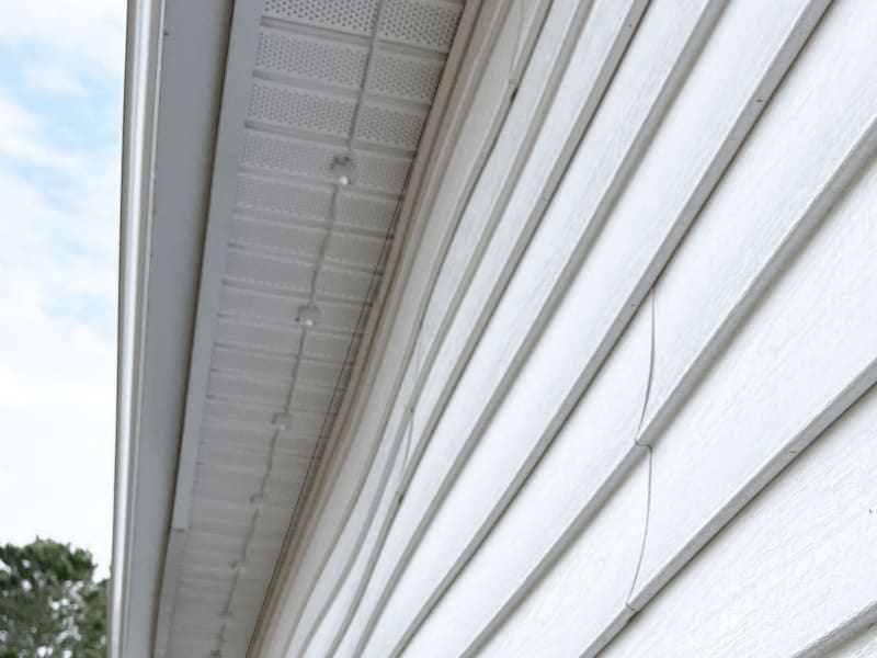

Has anyone encountered regular/periodic undulations or waves in exterior wood framed walls that use quick tie holddown cables? I am seeing 3/4" to 1 1/4" waves about every 6 feet in the sidewalls of a one story wood framed structure, with no apparent explanation.
 https://files.engineering.com/getfile.aspx?folder=63441f71-6704-400c-8ba9-6e3ddcdd40c6&file=IMG_4262.JPG
Looks like thermal expansion induced buckling of the vinyl siding. Likely because it was nailed on "good and tight" instead of loosely to allow for expansion and contraction.
What is the exposure of the surface w.r.t. sun and what is the supported structure? Are there enough studs in the wall? Is the top of the wall secured to the upper structure adequately? The top plate looks bowed from the outset as no gaps or buckling has developed at the eave finish. In the image below, I extended a line to the corner of the house. The issue looks worth opening up to investigate.

It's thermal and moisture driven as far as I can tell.
The way to sort it from what I have discovered is to have a double batton with a 20mm expansion strip covered by a 40mm vertically external. And oval nails thin in the direction of movement on the other battons. Expansion strips every 4 meters.
If vinyl siding, one of the properties of vinyl is that it is not dimensionally stable and tends to increase with time. Most commercial product literature cautions about this. I did an engineering report about 20 years back on a dairy barn where this was the problem... long lengths of the material without proper joints. This was contesting another engineering report where the engineer missed that. Their product literature clearly indicated this problem.

How is this presumably vinyl plank secured to the walls?
Looks very much like lack of fixing/ not enough room for expansion.

I'd guess the siding company screwed the panels tight and left little to no gap.
Exactly the problem with the dairy barn. The engineer that did up the original report had overlooked that.
The siding was attached firmly to the structure, I pushed the siding in to make sure it was not the material that was bending. It appears to be the wood sheathing that is bowing
