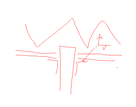

Thanks for the response. I admit I did not provide adequate background information. The existing racking is being modified such that two of the bays from the existing racking system will be removed to allow for space required for other use by the building owner.
Based on my analysis, I found that even the existing racking setup (6 x 6 grid with roughly 5 ft spacing in each direction) is only braced in one direction but not in the other. I am trying to brace the framing in the direction that currently does not have "X" or "Diagonal" bracing by connecting the two corners of the framing to the roof. The load path for lateral movement in this direction will be through the member into the roof, roof deck, and global lateral resisting system. The reason I am thinking of attaching the racking to the roof joist is that there is nowhere I can add vertical "x" or "diagonal" bracing in that particular direction as it will block the way for operators to get in/get out to place/remove pellets.
You had suggested welding a continuous L3x3 to the bottom chord-like bridging. I was thinking of achieving this by using an angle as shown in the sketch below. I am just concerned about the torsion that I will end up introducing in the channel due to the connection offset. The amount of torsion is likely going to be relatively small say 3-5kNm/m. I am thinking I can reinforce the joist by adding vertical members at the panel points.
Thoughts?
Yes, you got it. That's kind of like what I was thinking. That will work. If you're worried about torsion, the torsion will be shared by several joists with that channel, so it's not really a concern.

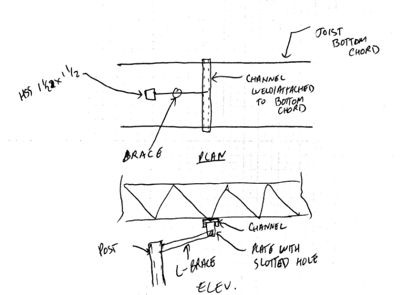

I think that your goals here ought to be:
1) Engage the joists laterally along their own axes.
2) Try not to engage the joists vertically. This, to avoid:
a) The racks holding up the roof and / or;
b) Roof load causing your racks to tilt over if diagonal braces are used without a movement joint.
3) I've proposed what I feel is a simple solution below:
a) Extend the vertical posts up through the truss bottom chords.
b) Capture the posts laterally on both sides with angles welded to the trusses but not connected to the posts.
c) Maybe add some truss bridging near the connection for good measure.
I like KootK's solution. There is still the torsion problem, so I'd definitely use his last point about adding some truss bridging. Also to add to his idea, if you use vertical long slotted holes to the angles, you will not engage the posts for vertical loads.
I don't actually see a torsion problem with this. Or, at the least, not the torsion problem that OP mentioned which was a result of the vertical offset between the point of load delivery from the rack and the back of the channel. With my detail, I see the horizontal load getting transferred primarily at the horizontal legs of the angles, just below the bottom of the bottom chord. With respect to that eccentricity, I suspect that the angle connections to the post and joists would rectify that handily.
