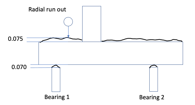

I have a roller bearing, the cup and cone have a circular runout tolerance. The hub that the shaft and bearing are inserted also have a circular run out tolerance.
I am a trying to understand if the cup and cone tolerances will add/stack up and affect the hub run out?

Runout is, worst case, nominally twice the radial offset; if the runout of the bore to the OD is 0.0002, then the offset of the axis is 0.0001. (inch tolerance) Radial stack is linear stack + phase. In phase they add, 180 degrees out, they subtract.

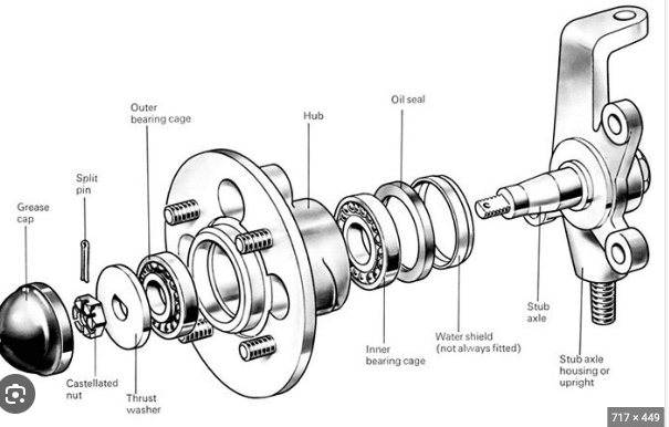

This is for a wheel bearing. I am trying to find the radial stack up of the inner and outer bearing and the hub.
Circular Run Out
Inner bearing = 0.070
Outer bearing = 0.070
Hub = 0.075
The datums A-B are the bores.

Would radial run out stack simply be bearing circular radial tolerance + the hub radial tolerance ( 0.070+0.075) = 0.145
Runout is between a surface and an axis. In a bearing there is runout between the bore and the inner race and another between the outer race and the outer surface and between the bore and the outer surface. The hub has runout between the bearing bore and other surfaces, though except for the radial location of the studs / wheel bolt holes, it doesn't matter much.
Are you looking at runout around the bearing bore or about the outer race as the hub turns on the bearing?
I took the run out tolerance of the inner race and outer race and summed them to get 0.070. I.e, Inner race r/o tolerance 0.035 , and outer race 0.035.
I am looking for the runout on the surface of the hub, and how both bearings run out contributes to it.
0.070 is the value to use if the bearing is seized with rust and the hub is spinning on the hub shaft.

What is the surface that controls the axis of rotation?
I believe it would be the hub bore, the surface that the bearing cones insert.
