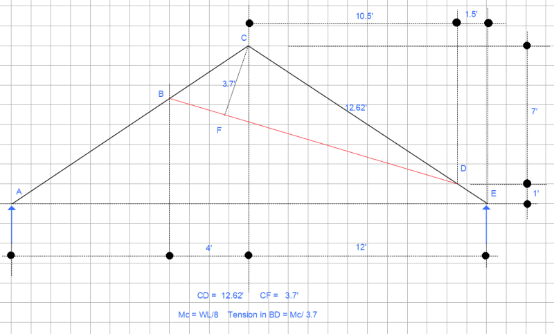

Assuming w = 1560plf, W = 37440#, R = 18720#, Mc = 56160'#, T = 15,178# say 16 kips
EDIT: Oops, I think I made a mistake in the moment, Mc.
Mc = 37440*24/8 = 112,320'#, T = Mc/3.7 = 30,357# say 30 kips
So if a double tie is used, the tension would drop down to 15 kips if the rafters have equal stiffness. If rafters are not equally stiff, the tensions would not be equal.

You are correct about the moment, Mc. It has been revised in my previous post to 112,320'#. And the tension has been revised to about 30 kips for a single tie. For a double tie, it would be 15 kips.
If you used a normal rafter tie, 1'-0" above the supports or 7' below point C, the tension would be Mc/7 or 16,045#. It should not be surprising if you consider that a horizontal tie has a lever arm of roughly twice that of the sloping tie.
I didn't draw a FBD. The tension in the cable is the simple span moment divided by the perpendicular distance from the cable to point C.

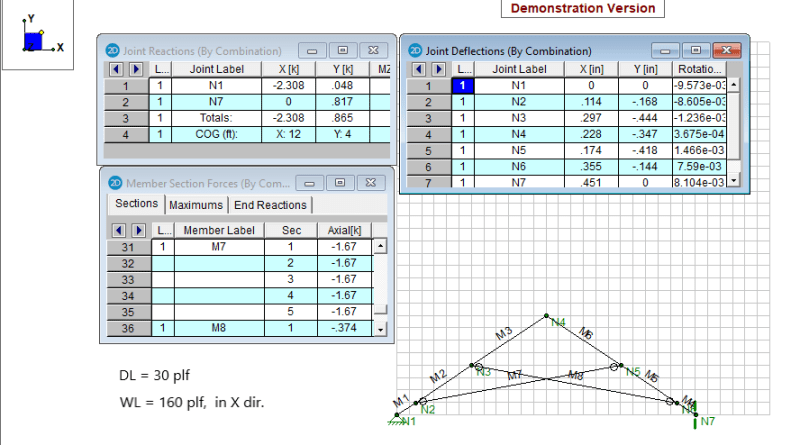

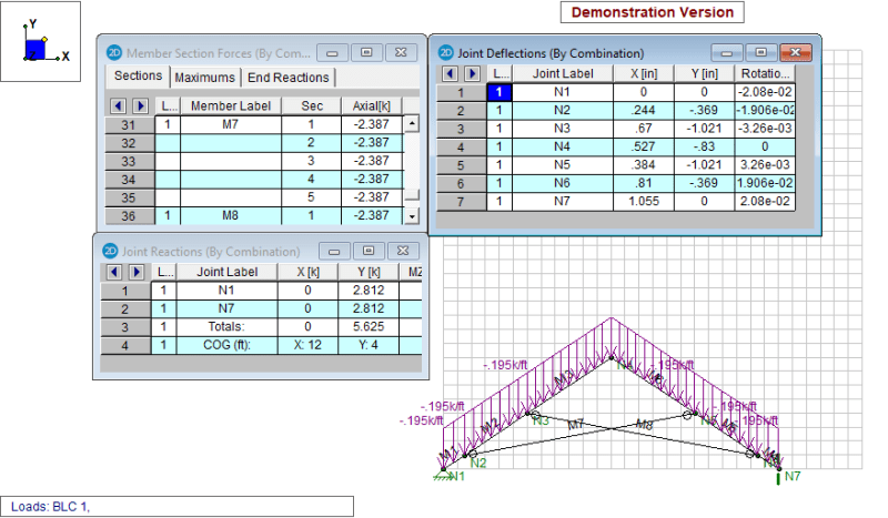

For purpose of discussion, analyses were performed on a model assuming rigid ridge point. The first graph shown analysis results for DL+SN, and the second, for DL+WL.

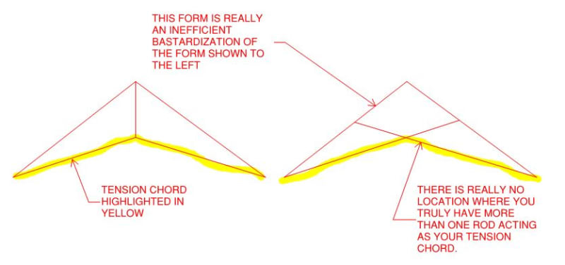

Yeah, I feel 'ya. For me, the key is the recognition that you don't actually have more than one rod acting as your truss's tension chord at any location. Perhaps the sketch below will speak to your intuition a little more than FBD's.
retired13,
[li]I'm not sure how you would get a rigid ridge point using timber rafters. I assumed a pin joint for Node C (your Node N4).[/li]
[li]Your load of 0.195 k/ft does not correspond to the reactions shown, i.e. 24*0.195/2 = 2.34k (not 2.812k at N1 and N7)[/li]
[li]N3 and N5 should be 4' each side of N4, not where you show them.[/li]
This makes comparison of our results difficult.
BA
If the ridge point remained pinned as in the simple truss construction/analysis, without restraint at wall-roof connection, the outward deflection of the legs could be huge. The stiffness of the cables is crucial in minimizing the lateral deflection, the cables need to work together. Suggest to consider making the ridge connection as rigid as possible.

Why not do a check to see the effect (I did above, in case you've overlooked)? Also, the stiffness of the rafter will play a role too.
I agree that the rafter stiffness will play a significant role in the magnitude of spread, but the rigidity of the ridge node will play a minor role. In any case, moment connections in wood members are difficult to accomplish.
