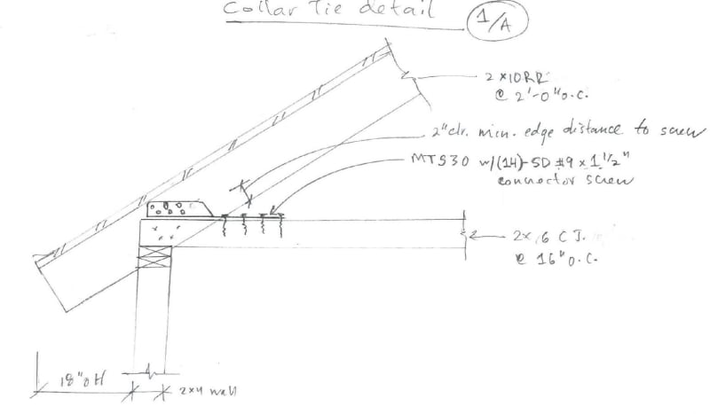

Hello,
I'm working on a design to reinforce the roof structure of an old retiree friend’s house that suffered structural damage due to recent heavy snowstorms. The attached sketch shows a cross section of the rafter tie connection on a portion of the house. There is a 44" height offset created by a cripple or knee wall. The challenge I’m having is determining what would be the best engineering practice to resolve the thrust reactions of the rafters. Would it be practical to design a plywood connection or lap the existing rafters/ceiling joist to make the typical rafter tie connection? Please know that I'm not a structural engineer and I would appreciate any feedback and or suggestions.
The roof pitch is 6:12, 2x10 RRs at 2’oc, 2x6 CJs at 16” oc.

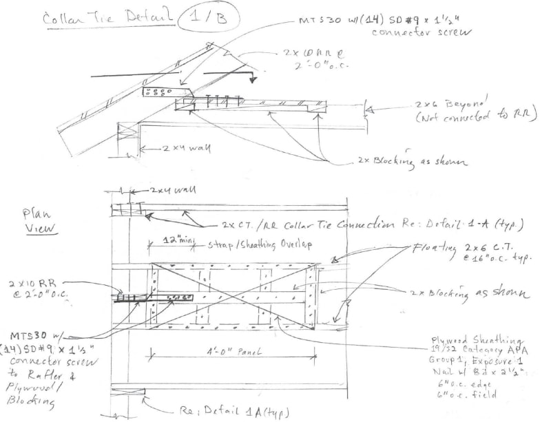

1. Please see diagram A and B which to my best knowledge was the best I could come up with. I never thought about using the top plate to CJ as a load path, very good suggestion!

Also, I thought about a designing a connection between the CJ and rafter bearing on the knee wall to resist the difference in forces. Any thoughts on this?''

Those details seem reasonable in terms of resisting rafter thrust. They're nicely drawn as well. I've used similar details many times using the twist strap that you show.
If I'm interpreting Detail 1/A correctly, you would still have an issue due to the different spacings of the rafters and ceiling joists. Perhaps you're showing Detail 1/B to address that, though, in which case I think it makes sense.
For Detail 1/B, while what you show seems adequate off the top of my head, I would be more inclined to run a flat 2x on top of the ceiling joists positioned such that the twist strap nailing goes into it. This 2x (which might be a 2x8, 2x10, 2x12) would be attached to the top of each ceiling joist. If that can work for the thrust force, it would be a lot simpler to construct. If that doesn't work, though, then I would look at a solution more along the lines of what you show.
I still think the thrust force is probably small or negligible, but if there was thrust to be resisted, I think the way you're generally approaching it is correct.
