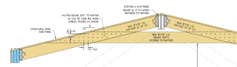

I have a client that builds portable shed buildings, and I'm wondering the necessity of rafter ties in high snow load areas (50-70 psf). I understand the building code is pretty straightforward on the need for rafter ties and/or a ridge beam, but I was wondering if there are alternative solutions, or perhaps the sheds are exempt from this requirement given the low risk to human life. The max width on the buildings is 16'. Ridge beams are not an option as the buildings are up to 60' long. The deflection at midspan would be far too much to handle. As always, they'd like to get as much headspace as possible, and it appears other shed companies in the area are not using rafter ties, only collar ties. That's not to say what they're doing is correct, but an engineer is signing off on the plans which raised questions for me.
So my questions are: Are storage sheds and other U buildings exempt from rafter tie requirements? If not, would the roof sheathing be enough to transfer in-plane stress to the support walls and negate thrust? I feel as though the small building width is compact enough such that deflections necessary to cause thrust aren't likely if possible at all. Thoughts?
