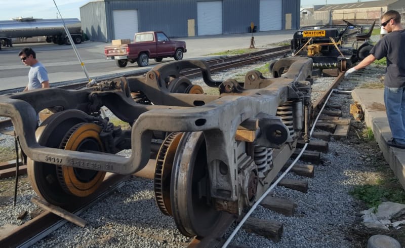

Itsmoked’s photo is not a std. three piece freight car truck. That is probably an old passenger car truck, maybe some transit equip., given its general arrangement and brake discs and springs and snubbing, etc. The term tapered refers to the tapered roller bearings which are std. today. I’m not sure where the Santa Fe info. came from, but everything I ever designed and built for them, maybe a couple dozen special railcars, used std. AAR components, sometimes with their preference for a specific manuf’er. for some specialty components. They were really a first class RR and a pleasure to work with, their Mech. Dept. was top notch and generally easy to deal with. I had a number of good friends there.
