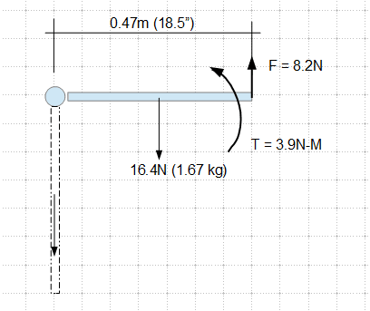

The toy chest door/lid is a rectangle of 14" x 18.5" and weights 1.67Kg
The axis/hinge is a threaded rod 10mm in diameter. I attached a wooden disk (Dia. 1.75") sort of as a knob to open and close the lid. Very hard to do by
hand. I calculated the torque required by assuming 1.67Kg on the center of the rectangle times 9.25" = 38.61 N.M
Since my wooden disk had a diameter of 1.75" (44mm), I caluculated that I needed a force of 175.53 N applied on the knob to raise the lid.
I want the normal position of the lid to be in the up/open position. I connceted up 180N of gas springs using a S.S. rope to the outside of the disk (knob) It not only raised the lid, it almost knocked it off of its axis. So much for my tourqe calculation. I experimented and found out that I can do it with a 100 N gas spring. So I want my lid to stay up all the time unless someone closes the lid. Once it is closed the spring can not raise it because I used a kitchen cabinet door (push release) latch to prevent the spring from opening.

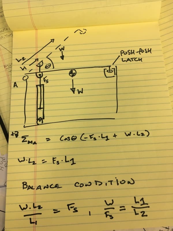

One is that you did not calculate the energy required to open the box lid. As the lid gets higher it takes less energy for every degree of opening, which means it requires less and less force as it opens. The nearly constant force of a gas strut means that it continues to provide the same amount of energy input throughout.

Please do not mix units, it is confusing. Below is the torque on the spring.
You CAN calculate the force and energy required. I spent nearly four years solving this exact problem a hundred times over.

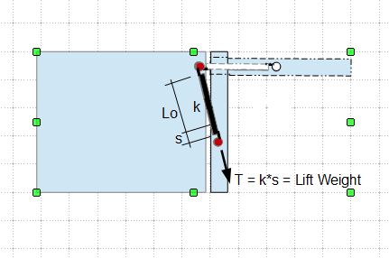

Start with a graph. Excel is great for this. Plot two curves:
[ol 1]
[li]Closing torque about hinge axis due to gravity vs angular position[/li]
[li]Spring torque vs angular position[/li]
[/ol]
5 degree interval is usually sufficient.
Wherever spring torque is greater, the spring is pushing the lid up. Points where the curves cross are resting points.
For torsion springs, the process is simple. Torque is linear, calculated from angular preload and spring constant.
Gas springs or other compression/tension springs are dependent on the endpoints. Torque is the product of force and perpendicular to distance to axis. This distance will change as the lid opens, so distance needs to be recalculated/remeasured for each position. It's a triangle with two known legs and known interior angle, so it's solvable. Formulae available in Machinery's Handbook or elsewhere on interweb.

Thank you @r13 for calculating the Torque required. Sorry for mixing units. When I built this using a gas spring, I arrived at the same Torque number. I am not sure if I did the rest correctly. I needed to have my gas spring hanging vertically in the back. Since my hinge/axis of rotation is only 10mm in Dia, I would need a Gas Spring with a force of 780N if I were to strap the gas spring to the 10mm hinge/treaded rod axis. So I stuck a 44.5mm diameter disk to the end of my rod. This way I ended up needing 177N. It turned out that when I tried it, 177N was too much so I manually adjusted it to 100N. Someone explained earlier that I had not taken into account the energy.
Anyway the Gas Spring idea is not feasible, because it physically does not fit my requirements.. I need to go with a Torsion Spring.
QUESTION IS: DO I GO WITH THE 3.9 N-M Torque @r13 has calculated or since Torsion springs come with different length legs somehow that affects the Torque.
@TheTick Thanks for the explanation and making graphs. One point, I am not really building a wooden toy chest. I can't reveal what I am building. However, the Toy Chest example pretty much covers what I need to do. There are somethings that I cannot do like the good suggestion by @moon161 for the push-push latches. I can't install them in the front of the toy chest. There is no toy chest.

Your problem with a torsion hinge is that the spring moment is nearly constant but the moment from the weight of the lid is w*l*cos θ, as shown in my sketch above. As you found it will accelerate the lid more and more as it opens.
You could use various mechanisms with a linear or rotary driver that have the force diminish as it opens.
A real simple one is just a torsional spring that is relaxed (zero torsion) when the lid is vertical.
