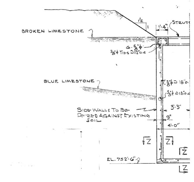

I have a wall that is 14.5 ft tall and from base to almost mid-height behind it is "Blue Lime Stone" and from mid-height to top of wall is "Broken Lime Stone".
My soil mechanic knowledge is a bit rusty. Could someone kindly tell me that do I have any lateral pressure applied to wall?
Any of above mentioned items will exert any lateral pressure on wall? any other lateral pressures?
Thank you
Skj

I included a pic of the wall drawing. Hope is displaying it here.

Broken limestone and the soil above will likely apply a lateral earth pressure. Blue Limestone may apply a lateral earth pressure, or maybe not. It just depends on its condition, fracturing, and which way the joints are dipping. There's no drainage system in the sketch to protect the wall from hydrostatic pressure. The bedrock may be fractured enough to allow water to seep into the ground and allow hyrdostatic pressure to build up. I don't have enough information to provide you with any real numbers or recommendations. You should contact (or hire) the project geotechnical engineer to find out how to approach your situation.
So far so good. My bet is the rock stands by itself and any filling between rock and wall has the"silo" effect. Means little if any pressure on the wall. Drainage apparently is adequate with this history of no problems.

So does that mean I just have a lateral pressure due to "Broken Limestone" on the upper half of the wall?
Is the lateral pressure distribution of the "Broken Limestone" is like soil a triangular pressure zero on top wall and max on the midheight?
Shall I not consider a saturated gama for Broken limestone since is draining well?
I appreciate if somebody can draw me the load or loads on this wall.

You are not in the wrong area. It is just that your question about lateral pressure from rock is not easily answered. The rock pressure could be very little to none or, based on inclination of sliding surfaces, it could be great. Without better rock information, determining lateral rock pressure would just be an educated, conservative guess.

By the way you are not using terms that we use to describe the rock. A geologist likely can clarify the condition. I'd take the term "broken limestone" to mean it was once blasted and just is a pile of loose rocks.
Sounds like this is a water tank of some sort. If you're just checking the wall then I would first take a look at its current condition. Are there any signs of distress? If not, then I would run a couple of scenarios to check the factor of safety. If you do see distress and there are unwanted affects from the tank walls failing then consider hiring a geotechnical engineer to help assess the situation.
For now, scenarios should be ran with the tank empty and add any surcharge loading that is applicable. I would first assume the blue limestone is stable and doesn't provide any load on the wall and the broken limestone will have a friction angle between 28 and 32 degrees. If factor of safety is satisfied then proceed to check if the blue limestone is not stable and give it a friction angle of between 30 and 36.

Is this the side of a round tank, then a whole different picture is present. If concern is that the "wall" might cave in, then the arching of tank walls comes in as resisting pressures from outside.

without any geotech/geologic data, strictly speaking there is absolutely no way to know what the lateral loading conditions are. if you are going to make assumptions, best to get a local geotech to make them.
does it check out if you assume all heavy and saturated soil against the wall. The contractor would have had no obligation to leave any limestone there. you don't need geotech for a 1st pass at the comps if it checks out under those conditions.
