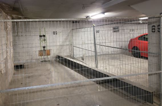

I read your post as if you were trying to steal my identity. Literally have a bazillion W8x18s / W12x35s kicking around from temp works and repurposing them to suit. Below is a picture from today trying to do just that! Note the cut ends (torched off from previous angle connection)
