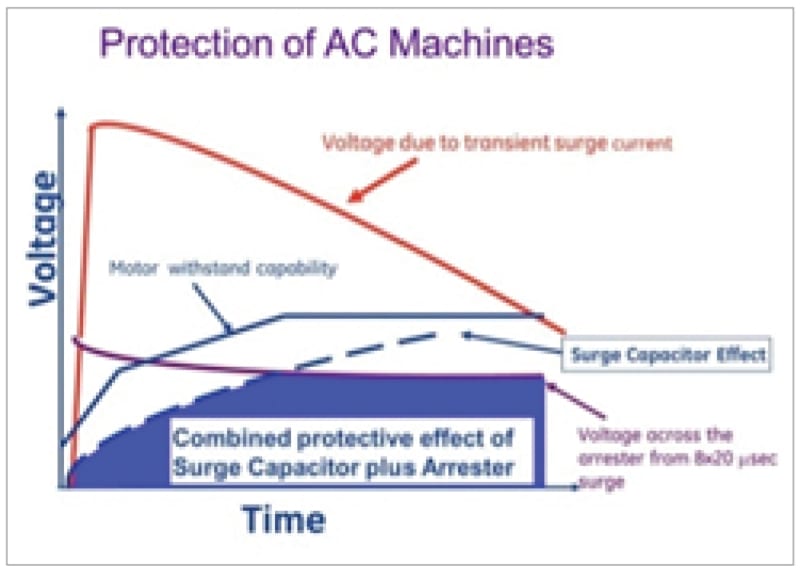

Consider to include In the cost/benefit analysis the secondary beneficial effect of connecting a capacitor to the motor not only to improve the PF but also to increase the surge protection to the winding insulation by reducing the steepness of wavefronts applied to or reflected within the motor windings as shown in the graph below.
