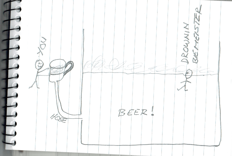

EDMS Australia
Beer and froth! I wish.
This is where the beer/froth analogy may have some validity.
You can change the froth level in the stein, which as all electricial guys know, is the Q. But, by doing so, you cannot change anything in the fermenting vessel. And you cannot do much to the V, either.
Der Brauermeister, who so unfortunately fell into the vessel, is fighting for hs life. His death is slow and painful, he has already been out of the vessel four times to take a pee. But his time is over - he is not sure if he can find his way back to the vessel if he tries a fifth time. So he will die. Not so beautifully, but happy.
