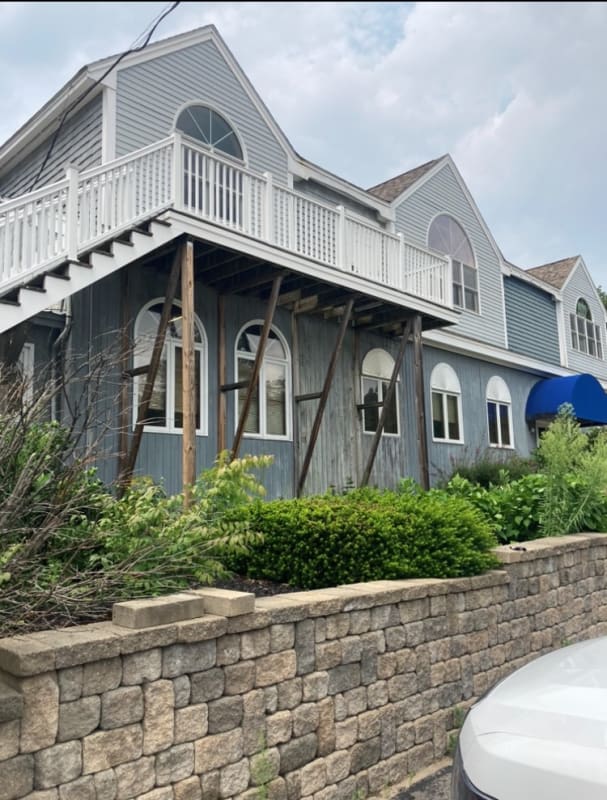

Has anyone tried eliminating the rear posts and using a 45 degree kicker back to block wall (or footer). This is a steep hill and my client wants to eliminate more footers and piers. Seems pretty simple but I am having a rough time figuring out the best connection. A 6x6 post diagonally connecting back to the band/double 2x12 is putting way too much shear perpendicular to grain that I would need a million bolts. Any cool ideas? Obviously the wood is the weak link. Other end of deck will be a ledger.

I believe I have a good way but it will add material and add depth to the deck. Basically have a double 2x (tension member) on a ledger at the cabin and the other end supported by the kicker. Two 7/8 bud bearing with the grain connected by steel plates down to the angled post which goes to footer. One of these scenarios for each post location and then the deck would sort of just sit on top.
Pull-out from the house is usually a big hurdle.
If it was a wood framed rear wall I could use those Simpson tension ties to the interior trusses. Grouted block and anchors are great but how to transfer that to the wood?
You would have to have enough diaphragm to transfer the point pull-out load at the brace to the distributed connection at each truss. Since there typically is no diaphragm on a deck, then you would have to to react the entire pull out in one location. That can be challenging. Most engineers overlook about 50% of the load paths on these jobs.
I agree with xr250. maybe there's a solution if the owner can accept that resisting these forces will require a significant connection to the floor framing system of the structure. Something like: long steel rods anchored at multiple points along the length of the floor framing and a plate washer resisting the force through compression on the outside end. make it so that the diagonal can't fail unless the whole cabin goes with it.

Well at least I know I wasn’t crazy when my forces I resolved were not cooperating with the lumber
I have a 16” rise and an 8 foot run so there’s that. I’m going to think on it some more.

I ended up getting the numbers to work out pretty well with an 8x8 kicker. Vertical load transmitted in bearing and the thrust I transmitted using 1” diameter bolts with steel plates sandwiching a triple 2x12. Tied back into the masonry block with multiple Simpson tension ties. I feel sorry for the guys that have to manhandle that 8x8 up there
