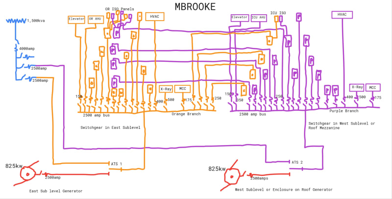

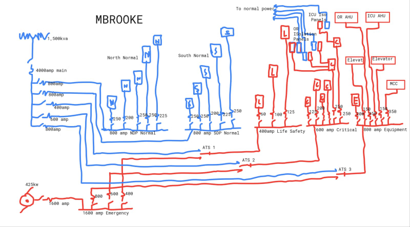

Yup- sizing correctly and having the right protection with selective coordination is key. As well as having more than one backed up system to critical areas- but doing so could actually violate code...
Here is an example of what I have in mind >>>
VS
This:
The prior stems from the practice that it is becoming more and more common to backup everything in hospitals. If two independent branches exists with independent ATSs and backup sources, why would code mandate a separate critical and life safety branches when arguably drawing number one provides that same level if not better redundancy?
Ie, in separate Life Safety, Critical and Equipment branches require that the generator have its own dedicated switchboard instead of directly feeding into a single ATS.

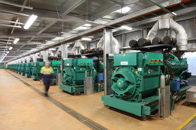

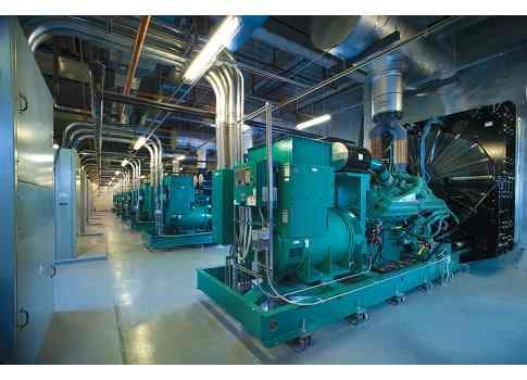

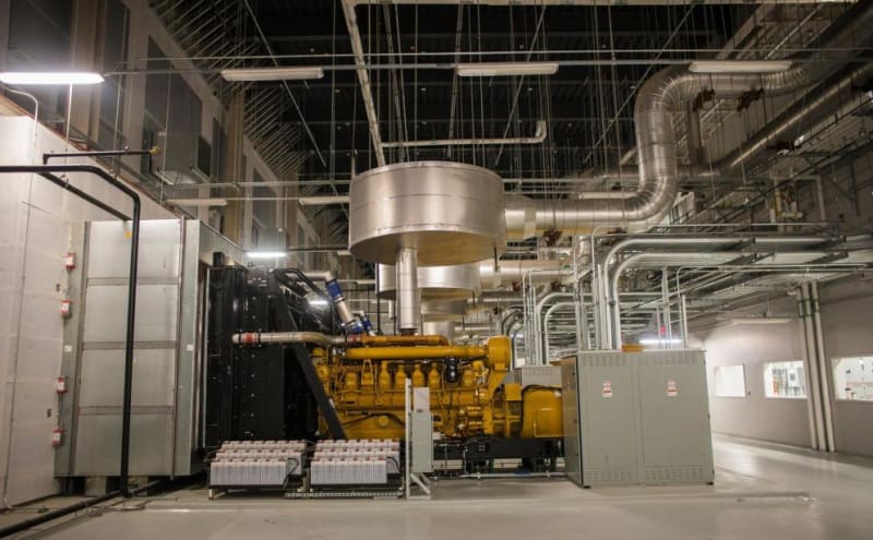

Time and time again I'm seeing this in hospitals- feeding everything through parallel gear:
I want to take the same and run it into individual gear/ATSs dedicated to one genset like this:
So having 6-12 separate systems.

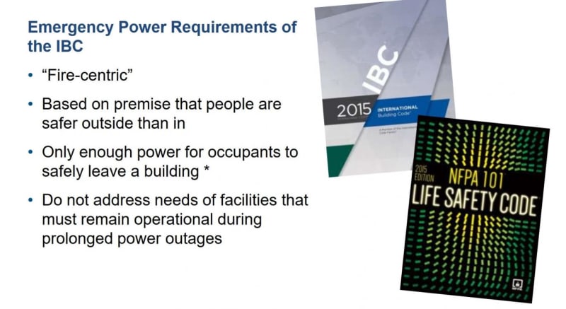

The case made for full power and paralleling:
the life safety branch .... these loads would include a very small percentage of a hospital’s total electrical system, typically 5% to 10% at most
Where life safety power would only be 5% of the building’s power requirement, the critical power system of a hospital could easily account for 25% or more of a hospital’s total power requirement.
The equipment system can easily account for 30% or more of the overall hospital electrical system.
In summary, the total amount of emergency power for most buildings (and therefore the amount of emergency distribution equipment needed) is typically 10% or less and consists of only that minimal amount of power needed to help people safely exit a building within the first few minutes of normal power interruption. For hospitals, emergency power becomes the life blood of a building without utility power and must be maintained throughout a power outage, which could last for days after a storm or other catastrophic event. As a result, it’s not unusual to see the emergency power of a hospital exceed 50% or 60% of the building’s total power needs. Also, as separate transfer switches are need for each type of load (life safety, critical, nondelayed automatic equipment, delayed automatic equipment, and delayed automatic or manual connection equipment loads), multiple ATSs are always needed for hospitals. For a 200,000-sq-ft hospital, eight or more transfer switches could be used. A similarly sized office building would typically have only two ATSs.

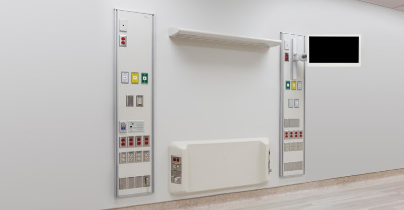

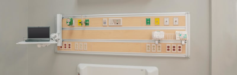

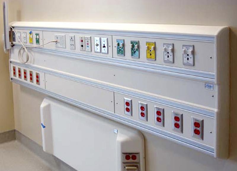

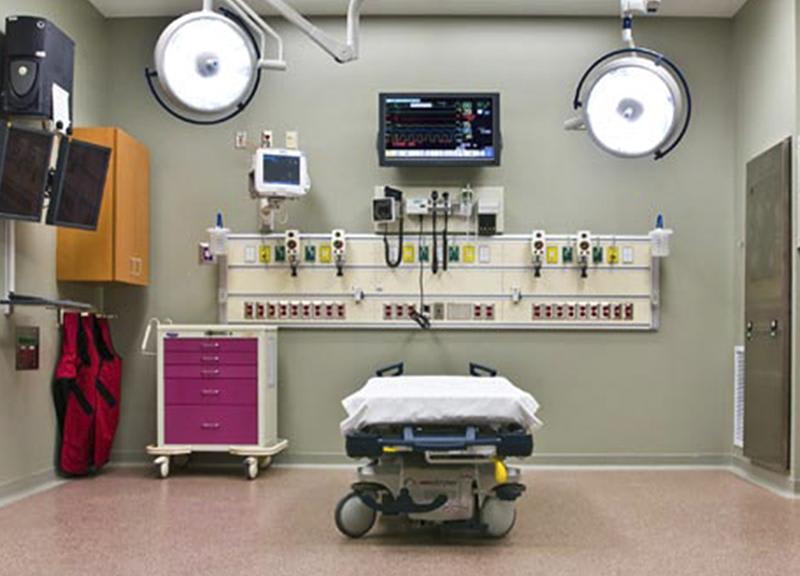

I came up with a design that is actually better, cheaper, ect but at the same time violates code in that there aren't 3 essential branches.
Instead 4-6 backed up branches with hospital load evenly divided among them. Critical care areas take circuits from all of these 4-6 branches. IE, a patient head-well such as this is supplied by 4 to 6 different systems without any common mode failure points.
Where as typically a you find this where the red outlets are fed from one ATS and critical branch and the white outlets from a normal branch.
