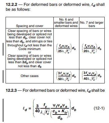

Below is copied from ACI318-08. I've no access to, nor knowledge on, ACI318-19 though. Please let me know my "gap" in my knowledge on the code.
12.2.4 — The factors used in the expressions for development of deformed bars and deformed wires in tension in 12.2 are as follows:
(a) Where horizontal reinforcement is placed such that more than 12 in. of fresh concrete is cast below the development length or splice, ψt = 1.3. For other situations, ψt = 1.0.
(b) For epoxy-coated bars or wires with cover less than 3db, or clear spacing less than 6db, ψe = 1.5. For all other epoxy-coated bars or wires, ψe = 1.2. For uncoated and zinc-coated (galvanized) reinforcement, ψe = 1.0.
However, the product ψtψe need not be greater than 1.7.
(c) For No. 6 and smaller bars and deformed wires, ψs = 0.8. For No. 7 and larger bars, ψs = 1.0.
(d) Where lightweight concrete is used, λ shall not exceed 0.75 unless fct is specified (see 8.6.1). Where normal weight concrete is used, λ = 1.0.
Hint.... [bowright]K_tr[bowleft]
Perhaps re-read my reply. Requirements are similar in 2008 and 2019 code.

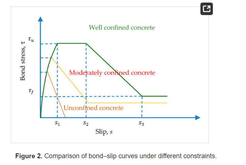

R13,
The below link is for high strength concrete beam, but does give you some very good perspective on the transverse reo and the effect on the behavior of lapped slices.
The transverse reo in my mind is providing some confinement to the reo, as would shear ligs in a concrete beam, which would increase the bond stress of teh reo, making the laps more efficient.
In seismic zones, often teh concrete codes have minimum requirements around confinement to ensure the bonds of reo do not reduce over the period of an earthquake.
rowingengineer,
Thanks for the information, I'll look into it. But I am not a researcher, so I don't have the knowledge to judge the "permissibility" of reducing splice length due to confinement of stirrups, or any other transverse reinforcement. At this moment, I am not aware of any proposed change in ACI regarding this matter, I chose to stick to the code for now, which can be very conservative. BTW, as a side note, that the excessive reinforcement clause is also not to be considered for splice length calculation.
